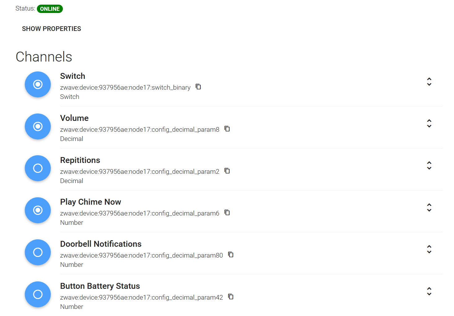

This is really a continuation of my efforts here to get my Aeotec ZW056 device to work: Item Type: Number or Decimal - #9 by Aaron23
With the 2.3.0 binding, only three channels show up when the device is first added from the Inbox, even though the database entry is showing six channels. The first is the Switch channel, which works fine. The second two are the Volume and Repetitions, which are both using configuration commands. However, as pointed out in the above thread, the channels seem to be configured with a “Decimal” data type which makes it impossible to create and link an item.
So I took a look at a few more example database entries that work similarly (e.g. GE zw4006) and made the attached updated database entry: zw056_0_0.xml (15.0 KB)
This is an improvement, because I have all 5 configuration command based channels available and can link them to proper items with Number type. However, updating the channels in Paper UI and Rules does not work. I’m getting errors like the following in the debug log:

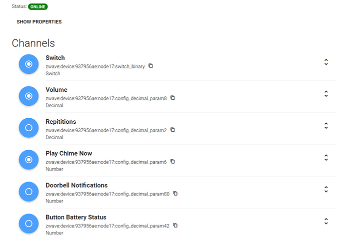

With this update, I have all 5 configuration based channels, but still faced with the following problems:
  1. Volume and Repetitions are still shown with Decimal types in the channel (in PaperUI, see attached), which means that I cannot link items. Volume is linked because of a link I had established before with “correct” types - from when I was using the database file I hand edited and attached to this thread. I assume openHAB automatically restores links because they are in the items files. On the Repetitions channel, I had unlinked one of these automatically re-linked items and now I cannot (though the UI anyway) link any item back.
  1. None of channels (even including the switch, which always worked before) are working now. This time, it’s a new error in the log. Three separate examples:

The config_decimal is always a Decimal type.
You should check the debug logs during initialisation to see what is happening. It’s likely that there will be some sort of error thrown during the thing init.
So if I wanted to use PaperUI to link to a Number item, do these channels need to be “typedef’d” like params’s 6, 80, and 42?

To summarize, here are all the problems I’m having:
  1. Problem linking items to channels that use Decimal type in the ZW056 device
  2. Problems using those channels even when I am using some modified version of the database. There are apparently two different error types depending on how the database was fixed (my fix attached to this thread, and your fix from the official database)
That is quite an old thread you reference and there was some confusion about the difference is channel types and item types. Changes were made after this - please check if it is working now with the latest binding and the latest definition.
For the binding, I am working off of the development branch of your fork with a fetch as recently as last week. Is that not late enough? For openHAB I’m using released 2.3.0
In the logging sense I guess these are not errors, but they do seem likely to be the reasons why I can’t send commands to channels:
16:21:42.407 [DEBUG] [converter.ZWaveConfigurationConverter] - NODE 17: Config parameter 6 not found in converter
22:05:33.126 [DEBUG] [nding.zwave.handler.ZWaveThingHandler] - NODE 17: Command received zwave:device:937956ae:node17:config_decimal_param8 → 5
22:05:33.126 [WARN ] [nding.zwave.handler.ZWaveThingHandler] - NODE 17: No command converter set for command zwave:device:937956ae:node17:config_decimal_param8 type DecimalType
I think the newer “No command converter” log messages are due to the fact that the newly updated and exported ZW056 database file is missing “COMMAND_CLASS_” in the channel definitions. When I add these in, I am at least back to the first log message “Config parameter X not found in converter”
I.e.
<property name="binding:*:OnOffType">SWITCH_BINARY,BASIC</property>
should be:
<property name="binding:*:OnOffType">COMMAND_CLASS_SWITCH_BINARY,COMMAND_CLASS_BASIC</property>
Hmmm … Now that I’ve waited a while, one of the channels is working (haven’t tried others yet). I’m wondering now if it was because the node was not fully initialized. I do remember that the node was in the GET_CONFIG? state (not sure I’m recalling that correctly) for a while and now it’s not.
Now I’ll go see if I can link my Number Item with the Decimal channel through the items files. Edit: Yes this works.
