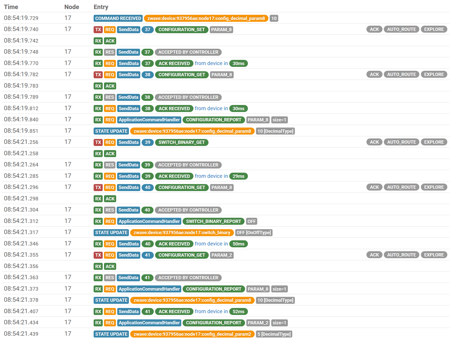

In case it’s any help, here is a debug log of setting the volume back to 10 from 1:
I have the text log too, but it’s too large to upload.
