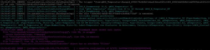

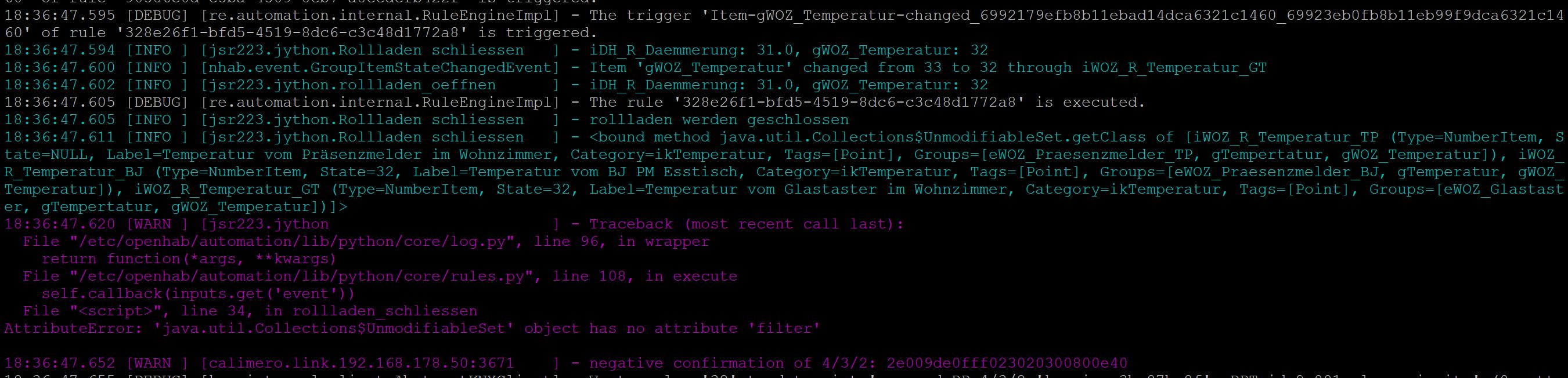

Every time I try to filter a group I get the following console output:
AttributeError: ‘java.util.Collections$UnmodifiableSet’ object has no attribute ‘filter’

Don’t post screen shots of logs or of code. It’s impossible to read on a phone, cannot be found in a search and in generally is less than useful. Please post the full logs as text in code fences the same as you do for rules code.
