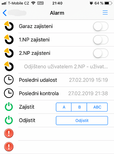

This is an example, how it might look like (JA80 Oasis)

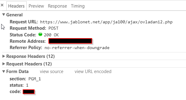

Hi @Stefan_Sa and @stex,
apparently the control of JA-100 is not working because I am unable to guess the right url address for control command. (unfortunatelly I own an OASIS alarm and the control is different so it returns a 404 error)
Could someone of you please:
  1. use Chrome to log in to Jablonet web (https://www.jablonet.net/) and click your JA-100 widget (one of them if you have more than one)
  2. press F12 on your keyboard
  3. try to control one of your sections and send me the URL and possible payload of the request
    (network tab of the debug window)
I need similar data as attached
to see the request URL and Form Data (you can use any invalid code or scramble it, the code itself is not required)
Ondrej

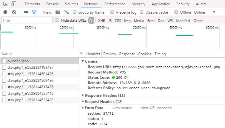

Hello Ondrej,
looks like the latest version is still not completely right.
(Still gives the “Not Found” exception)
So I did what you asked and am able to give you the next printscreen.
If you need something else, please ask…
thanks for testing and this screenshot. This is exactly I was waiting for.
I need more debug info about the URL the binding is trying to invoke. I am almost sure, I use the right url and I do not understand why are you getting “not found”
Please redownload this version
try to send usercode with OH2 and look inside the openhab.log for lines like: “Sending POST to url address” …
thanks
Ondrej

Well,
I finally got it working after clearing all possible dirs.
After clicking the switch thats linked to the pgm, it works.
Unfortunately, after this action the switch becomes kind of disabled and is unable to be triggered again…
The log says this…
21:39:21.138 [INFO ] [lotron.handler.JablotronAlarmHandler] - Sending POST to url address: https://www.jablonet.net/app/ja100/ajax/ovladani2.php to control section: PGM_1
2018-06-22 21:39:27.589 [INFO ] [lotron.handler.JablotronAlarmHandler] - Control response: {“ts”:xxxx,“id”:“PGM_1”,“authorization”:200,“result”:1,“responseCode”:200}
21:39:27.589 [WARN ] [lotron.handler.JablotronJa100Handler] - null response/status received
21:40:22.235 [ERROR] [lotron.handler.JablotronAlarmHandler] - Cannot initialize Jablotron service: xyz
----> the jablotron alarm gets the offline state
21:40:22.235 [ERROR] [lotron.handler.JablotronAlarmHandler] - Got response code: 302
21:40:22.388 [INFO ] [lotron.handler.JablotronJa100Handler] - getStatus response:
21:40:32.064 [INFO ] [lotron.handler.JablotronAlarmHandler] - Jablotron ja100 service:xyz successfully initialized
------> the jablotron alarm is back online
------> the switch is in a disabled state…
I find another strange logline in the events.log
After the switch action you suddenly try to start an oasis service…

thanks for the logs again. I have identified the problem - the JA100 response is different from the OASIS one so I’ve updated the control response handling.
Please try this version and let me know if it helps.
Thanks.
Ondrej
