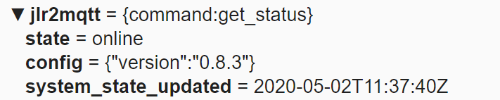

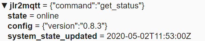

The above is all that is showing, and you can see I sent a get_status: mosquitto_pub -m "{"command":"get_status"}" -t "jlr2mqtt" -u "<redacted>" -P "<redacted>"
I also tried: mosquitto_pub -m "{\"command\":\"get_status\"}" -t "jlr2mqtt" -u "<redacted>" -P "<redacted>"
Which resulted in:
The jlr2mqtt.py is running on Python 3.6.9 on the console. It shows this output:

This occurs with the Moquette embedded broker as well as Mosquitto. Am I sending the get_status command correctly?
Couple of things to note in posting your command to the mosquitto broker:
The -m argument is expecting a string, but we need to send a JSON (which also uses double quotes internally to bound string items). To get around this, use single quotes around the beginning and end of the JSON and double internally within the JSON, as otherwise your JSON does not get through correctly; and
the topic that is being monitored for commands is jlr2mqtt/command (can be changed in the .cfg file), and not jlr2mqtt (which is just the root topic for the data coming back from the wrapper).
Also in your config file, try commenting out the DISCOVERY_SENSORS_LIST for now, so that you get everything available from your vehicle. This way you can check whether the filtered options you have specified ( door_is_all_doors_locked, position) are actually coming through from the jlr servers. You can always filter the list later once everything is working, if you want to.

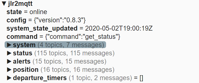

This fixed it, now I’m getting a JLR connection and some data. I am not however getting a homeassistant/sensor path as previously noted, and no items showing in the PaperUI Inbox yet.
Sorry, this seems to be step by step. Do you have any special Broker or Thing configuration in openHAB? My reading of the MQTT Binding docs led me to understand homeassistant items should just be discovered. I’m guessing they should show in MQTT Explorer first though.
Good to hear that you are now getting data into your mqtt broker.
If you run the wrapper script directly (e.g. running python3 jlr2mqtt.py directly from a shell), you should see the log messages from the script (they are also in the system logger, e.g. journalctl -f -u jlr2mqtt -n 1000 --no-pager). The first time get_status is called after starting the script, it should create the HomeAssistant entries, and post a message to the log saying that it has done so.
PaperUI Inbox should show the ‘things’ automatically as soon as we have the sensor data posted to the homeassistant topic as above.
