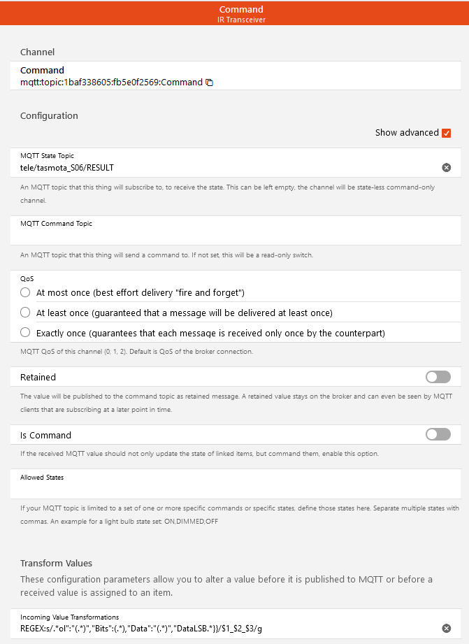

REGEX:
REGEX:s/.*ol":"(.*)","Bits":(.*),"Data":"(.*)","DataLSB.*}}/$1_$2_$3/g

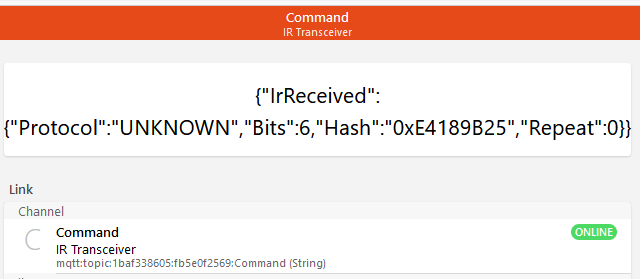

Tasmota Console:
18:46:19.583 MQT: tele/tasmota_S06/RESULT = {"IrReceived":{"Protocol":"UNKNOWN","Bits":6,"Hash":"0xE4189B25","Repeat":0}}
Item:
Working as designed or wrong result? IMHO undecidable on basis of the documentation:
RegEx - Transformation Services | openHAB - but I’d tend to ‘wrong result’, result should be NULL.
Exactly, seems that a “try and error” approach is the only thing to do here. When it could be so easy if only the JsonPath transformation wouldn’t return the whole string if there is no match (which really doesn’t seem to be a reasonable behaviour).
