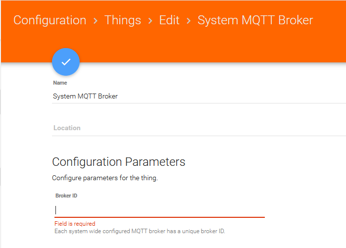

I deleted my MQTT Broker under Things in PaperUI and uninstalled the MQTT binding then followed an article I found on how to install Mosquitto..
I then went into openhab configuration > optional components and installed Mosquitto. I then went into Things in PaperUI and installed MQTT Broker. In the configuration there is a field for Broker ID.
The thing shows the same as the last one mqtt:systemBroker:embedded-mqtt-broker
Configuration of the broker needs a Broker ID.
Do you know what form the Broker ID should take?

You definitely need to re-install this, though!!
Careful, “System Broker” is not what you want, that is about the embedded moquette broker that you just abandoned.
You want a Bridge Thing under the MQTT binding, pointing to your mosquitto.
