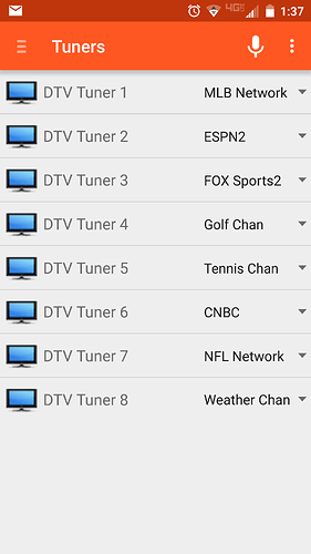

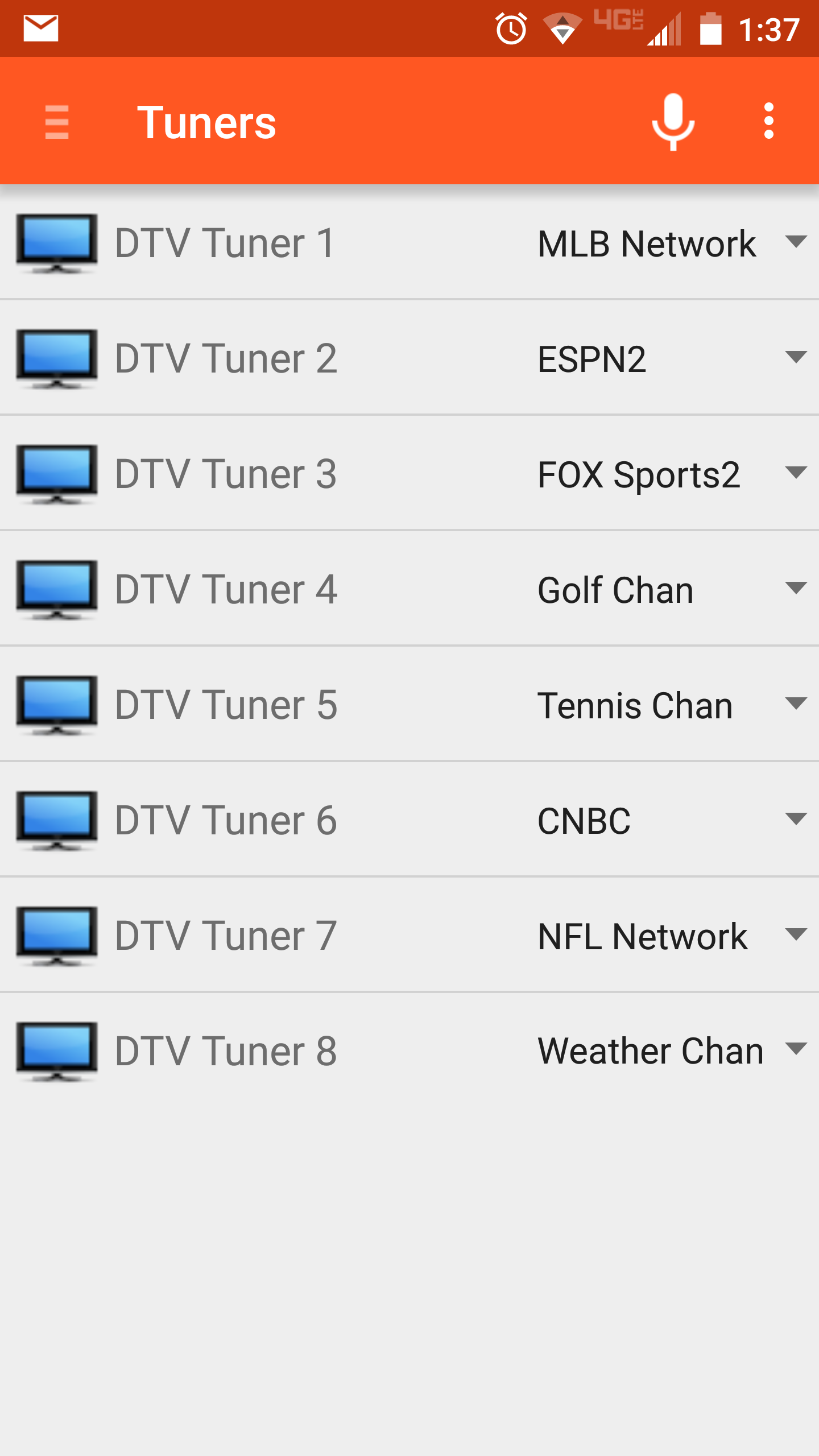

This is the screen that will have the tuners, the selection is just a list of the commonly used station names that when selected will send the TCP command to change to that channel on that tuner.

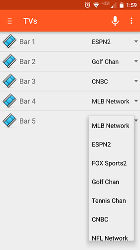

On another screen I plan on having the TVs listed with a selection on each one to pick which tuner for the matrix switch to select. Instead of the selection box text being populated with “tuner 1” “tuner 2”… I want to populate with the mapped station that each tuner is tuned into, eg. What you see currently selected in the first picture. So it should look like this…
But the contents of the selection on the TVs will change depending on what station the tuner is on.
