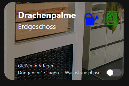

OK, this is where I got so far.
All content is hard coded so far as I want to get the styling right.
I am not 100% sure whether my approach behaves nicely on different screens (smartphone, tablet, 4k monitor).
What I can see on my phone as an example is that the “Wachstumsphase” (Growth phase) label is moving on top of the toggle button as soon as there is not enough space. The card looks “denser” on my phone. The screenshot here is from a 4k monitor.
How can I influence the background image? I.e. make it opaque or darker? With oh-location-card it is straight forward as you can set a brightness property. But how does it work with f7-cards?

Looks like a great start.
This is, in my opinion, the hardest part of styling. In particular font size. There are a couple of ways you might want to try and handle this.
  1. You’re forcing the font sizes with your css variables. But there are already built in f7 font size variables that you could use instead if you prefer: CSS Variables Reference | Framework7 Documentation many of these will be auto-calculated by the f7 library to be responsive to both mobile and desktop views.
  2. You can use the device object in your widget to respond to a desktop vs mobile display. device.desktop will be true on desktop browsers and false on mobile so you could define your font size css variables like this
--font-size-title: =(device.desktop)?('24px'):('16px')
Other than that I find that relying more of flex spacing than absolute width and height of containers helps with responsive design. That will probably help you with the problem of the text over-running the switch component.
You can always take a look at how the oh version of a component is defined to get an idea. In this case the location cards come from the base model card here, and the background is not actually a background setting, it is an image in the f7 header:
You can use html tags as components too, so you can put your own img in the card and apply a style directly to that image. You’ll just have to adjust the positioning of the first f7-row after that to be absolutely positioned over the image.
- component: f7-card
    default:
      - component: img
          src: /static/baddg.jpg
          style:
            filter: brightness(25%)
If you want to keep the image as a background style of the card, then it gets a little trickier. Applying a filter to a background image directly is not something that’s supported in css to my knowledge, so you’ll have to find some clever work-around. My first instinct would be to stack backgrounds. You can define more than one background with css, so you can probably define the image as the lower background and then a solid black background above that with an alpha value that would serve to turn down the brightness of the image.
Wonderful! Thank you for the kind feedback. It really motivates me going further. :slight_smile:
So you mean the width: 50% or height: xyz% directives for the rows/columns should be avoided and in the best case one only uses the align-items, justify-content and align-content properties to get a smooth experience?
That’s what I do for most of my widgets. Here’s a really helpful resource to give you an idea of everything you can do with flexbox alignment:
So, regarding the background image I decided to use the “overlay” approach. Inside the development environment it looks as expected:
But when looking at it on an overview page the black layer is above all other layers:
What we can also see is that the flex-spacing is somehow ignored. The same happens on my phone.
Any idea why?

Edit: I realized I have to add a top: -16px property to the f7-block otherwise the black image won’t cover the whole picture. This seems a litte bit odd to me. I’d also like to know why I need to do this. Any suggestions?
This one perfectly good solution. In fact, if you do this, then you don’t need the extra f7-block, just set the background on your first f7-row (you’ll also need to set border-radius on the row to match the card, 20px, if I recall, and give it 100% height and width).
My guess is that this will fix both of the problems you are seeing.
It shouldn’t happen that the editor view and the display view are any different, but I’ve seen a couple of examples of it over time. It just means that there’s some upstream css setting in the main window that is for some reason overriding one on your card. The flex styling is still working, but instead of you f7-row being the full height of the card, it’s height is reduced. That’s why I suspect that the fix above will fix the issue: it explicitly sets the height of that first f7-row explicitly.
So… I’d say the widget is ready for now and it behaves as I want it to behave.

Hooray! We are getting there! :wink:
Two questions I have:
  1. To get the location I’m currently doing quite an ugly hack. In my model the location is the 2nd group a plant is member of and each location has the following naming schema: “Location_Somelocation”. In German it is “Ort_Wohnzimmer” as an example. Due to this I can create a correct label with:
    loop.item.groupNames[1].replace("Ort_", "")
However, is there a more generic solution which is using the semantic model like
loop.item.location.label (which does not work unfortunately)?
  1. The positioning of the cards is not correct at the moment. They are all stacked inside a column and I can only move the column. The flex-direction: row property seems to be ignored. Any idea why?
    I would expect the cards to be next to each other.

Errm… it’s me again. I did some more tweaks to the widget inspired and a lot copycatted by OH3 - Expandable F7-card - Add-ons / UIs - openHAB Community
Again I tried to come up with the logic that I only assign all my plants in one group to the widget and it draws all the cards.
This works and looks nicely in the widget development area but does not really work on the main page. Clicking on a card on the main page only shows the card content in a blurred way. Clicking anywhere will close the card and everything looks as initially. I tried to play with the z-index but that did not really work out.
Any idea?

                          iconColor: "=(items[loop.item.name + '_Duengen'].state == 'ON') ? 'green' : 'gray'"
                          iconSize: 40
                          style:
                            height: auto
                            position: absolute
                            top: var(--mobileVerticalOffset)
                            right: 45px
                            z-index: 90
                          tooltip: Pflanze gedüngt
                      - component: oh-button
                          iconF7: xmark_circle_fill
                          iconSize: 30px
                          color: black
                          style:
                            position: absolute
                            right: 0
                            padding-top: 10px
                            padding-bottom: 35px
                            z-index: 90
                          class:
                            - card-opened-fade-in
                            - cell-close-button
                            - card-close
                      - component: f7-block
                          class:
                            - no-padding
                          style:
                            height: 200px
                            background: =`url(${loop.item.metadata.image.config.link})`
                            background-size: cover
                          style:
                            background: rgba(0, 0, 0, 0.4)
                            position: absolute
                            height: 216px
                            width: 100%
                            top: 0
                          class:
                            - no-padding
                          style:
                            height: 200px
                            position: absolute
                            top: 15px
                            left: 30px
                          default:
                            - component: f7-row
                                style:
                                  height: 75px
                                  display: flex
                                  flex-direction: row
                                  flex-wrap: wrap
                                default:
                                  - component: f7-col
                                      style:
                                        width: 50%
                                      default:
                                        - component: Label
                                            text: =loop.item.label
                                            style:
                                              padding-top: 15px
                                              font-size: var(--font-size-title)
                                              font-weight: var(--font-weight-title)
                                        - component: Label
                                            text: "=loop.item.tags[1] == 'Plant' ? loop.item.tags[0] : loop.item.tags[1]"
                                            style:
                                              font-size: var(--font-size-location)
                            - component: f7-row
                                style:
                                  height: 110px
                                  white-space: nowrap
                                  flex-wrap: nowrap
                                  align-items: flex-end
                                default:
                                  - component: f7-col
                                      default:
                                        - component: Label
                                            text: "= (items[loop.item.name + '_TageBisGiessen'].state > 1) ? 'Gießen in ' + items[loop.item.name + '_TageBisGiessen'].state + ' Tagen' : (items[loop.item.name + '_TageBisGiessen'].state == 1) ? 'Morgen gießen' : 'Heute gießen'"
                                            style:
                                              color: var(--font-color-addInfo)
                                              font-size: var(--font-size-addInfo)
                                              font-weight: var(--font-weight-addInfo)
                                        - component: Label
                                            text: "= (items[loop.item.name + '_TageBisDuengen'].state > 1) ? 'Düngen in ' + items[loop.item.name + '_TageBisDuengen'].state + ' Tagen' : (items[loop.item.name + '_TageBisDuengen'].state == 1) ? 'Morgen düngen' : 'Heute düngen'"
                                            visible: = items[loop.item.name + '_TageBisDuengen'].state != 999
                                            style:
                          class:
                            - card-prevent-open
                            - card-content-padding
                          style:
                            height: 300px
                            z-index: 110
                          default:
                            - component: oh-list
                                class:
                                  - padding
                                default:
                                  - component: oh-list-item
                                      title: Gießen notwendig
                                      item: Testpflanze_Giessen
                                      icon: f7:drop
                                      iconColor: "=(items[loop.item.name + '_Giessen'].state == 'ON') ? 'blue' : 'white'"
                                      after: "=(items[loop.item.name + '_Giessen'].state == 'ON') ? 'Ja' : 'Nein'"
                                      title: Düngen notwendig
                                      item: Testpflanze_Duengen
                                      icon: f7:eyedropper
                                      iconColor: "=(items[loop.item.name + '_Duengen'].state == 'ON') ? 'green' : 'white'"
                                      after: "=(items[loop.item.name + '_Duengen'].state == 'ON') ? 'Ja' : 'Nein'"
                                  - component: Label
                                      text: Gießplanung
                                      style:
                                        padding: 7px
                                        border-bottom: 1px solid grey
                                        font-weight: 600
                                        color: gray
                                        margin-top: 10px
                                  - component: oh-stepper-item
                                      item: = loop.item.name + '_TageBisGiessen'
                                      title: Tage bis Gießen
                                      icon: f7:calendar
                                      color: blue
                                      raised: true
                                      round: true
                                      autorepeat: true
                                      autorepeatDynamic: false
                                      enableInput: true
                                      fill: true
                                      item: = loop.item.name + '_TageBisDuengen'
                                      title: Tage bis Düngen
                                      icon: f7:calendar
                                      color: blue
                                      raised: true
                                      round: true
                                      autorepeat: true
                                      enableInput: true
                                      fill: true
                                  - component: oh-toggle-item
                                      title: Wachstumsphase
                                      icon: f7:sun_max
                                      color: green
                                      iconColor: yellow
                                      item: = loop.item.name + '_Wachstumsphase'
                                  - component: Label
                                      text: Gieß- und Düngeparameter
                                      style:
                                        padding: 7px
                                        font-weight: 600
                                        color: gray
                                        margin-top: 10px
                                      item: = loop.item.name + '_Giessintervall_Wachstumsphase'
                                      title: Gießintervall Wachstumsphase
                                      icon: f7:drop_fill
                                      iconColor: blue
                                      color: blue
                                      raised: true
                                      round: true
                                      autorepeat: true
                                      enableInput: true
                                      fill: true
                                      item: = loop.item.name + '_Giessintervall_Ruhephase'
                                      title: Gießintervall Ruhephase
                                      icon: f7:drop
                                      iconColor: blue
                                      color: blue
                                      raised: true
                                      round: true
                                      autorepeat: true
                                      enableInput: true
                                      fill: true
                                      item: = loop.item.name + '_Duengeintervall_Wachstumsphase'
                                      title: Düngeintervall Wachstumsphase
                                      icon: f7:eyedropper_full
                                      iconColor: green
                                      color: blue
                                      raised: true
                                      round: true
                                      autorepeat: true
                                      enableInput: true
                                      fill: true
                                      item: = loop.item.name + '_Duengeintervall_Ruhephase'
                                      title: Düngeintervall Ruhephase
                                      icon: f7:eyedropper_halffull
                                      iconColor: green
                                      color: blue
                                      raised: true
                                      round: true
