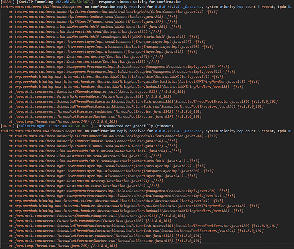

i’m running openhab for a long time and it was always a stable system.
Now want to use KNX in the Backend to connect my PIR sensors to openHAB.
After sometimes my KNX binding/configuration stops working with many failures.
If i reboot the system or restart openHAB it works a again as expected.
But i don’t know how long it runs without failures.
I’m running openhab on a windows server and OH version 2.5.5,
i have tested the knx configuration via .things file and also in PaperUI.
I have tested and searched here so much, but nothing helps for me and my system.
This is my the IP Bridge things config:
The hardware is an "Gira 216800 IP Schnittstelle (the german product name:) ) "
The Gateway is online and in the ETS monitor i can see all the telegrams.

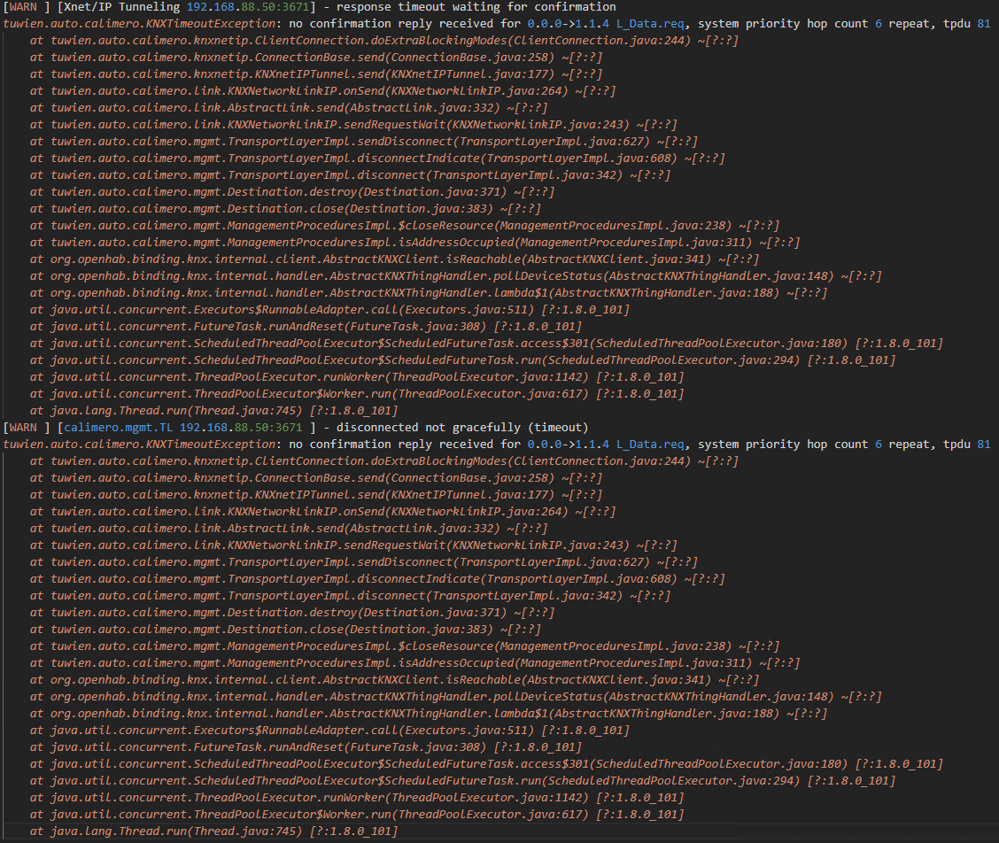

An example of my knx failures:
Please help me, i have no more ideas how to fix this problem.
thx a lot!

Hi there,
I digged through my logs and also have some issues from time to time (in my case the thing gets “offline”, but immediately “online” again).
I remember getting “no confirmation reply” messages some time ago.
Can you tell me if;
  • your bridge thing gets offline in that case?
  • you’re familiar with openHAB’s console?
Edit: please have a look into this.
