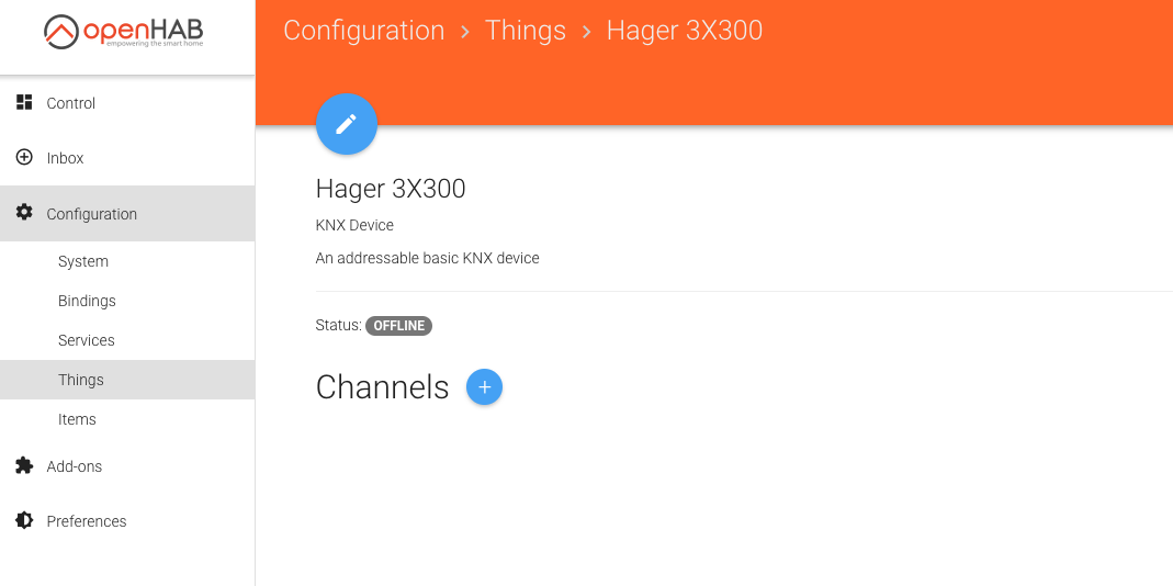

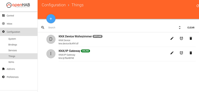

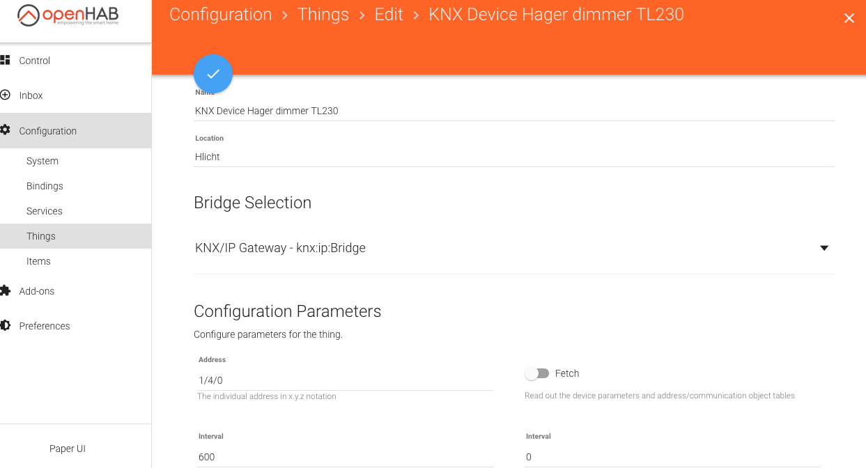

Can you show the details of the device “Wohnzimmer” ?

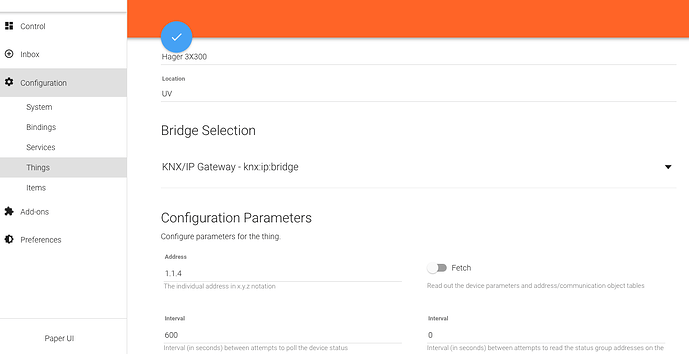

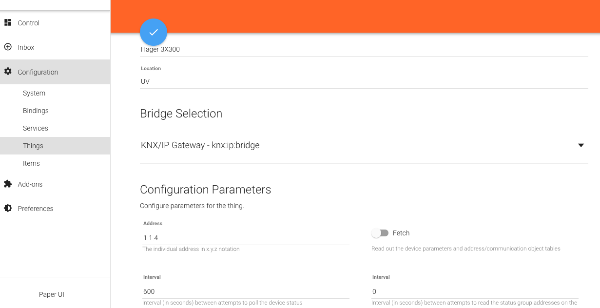

what shall i write on the KNX Device Adresse ? shall i write the PA of the actuator or the GR (for example a Licht) ??
I called the actuator Hajer … then i wrote the PA from this actuator in the Adresse but the result was not as i expected it, it was OFFLINE !

Please check the address (see the hint on the input field?)
You entered a group address where the address of the
( physical) device on the knx bus is required.
Group addresses are related to channels only.
Example :
You have an actor with the physical address 1.2.3 and single channel to switch. This channel is linked to the group address (GA) 1/4/5.
For the actor you have to enter the 1.2.3 as device address in OH, for the channel you enter the knx group address 1/4/5.
The error you get is clear, a group address is not a valid device address, these are different.
With a group address only the binding can not address the physical device (when adding channels or activating the fetch it is trying to actually read data from it).

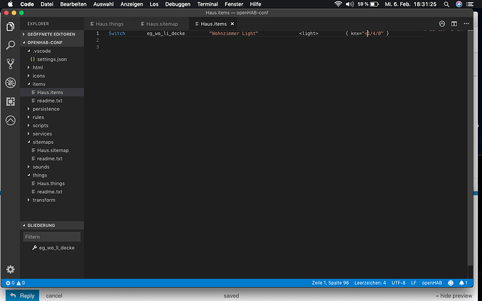

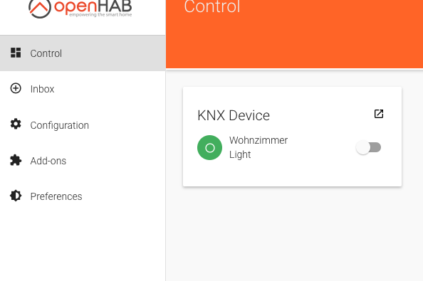

i just found that when i switch on the ''Wohnzimmer" flash/blinkt mein RETOUR

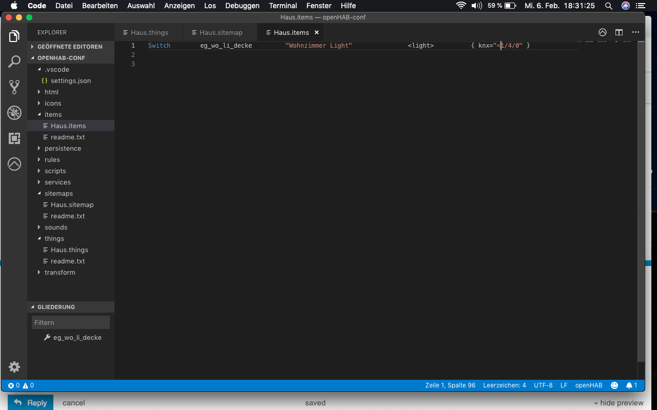

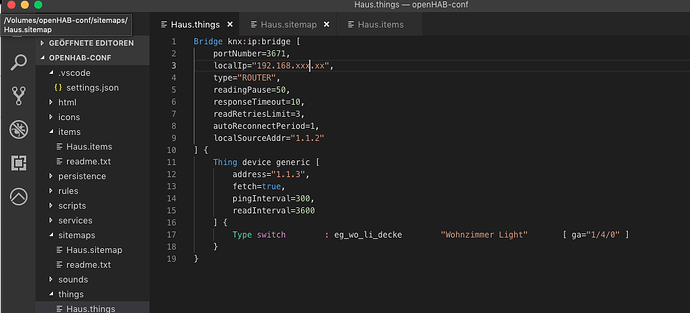

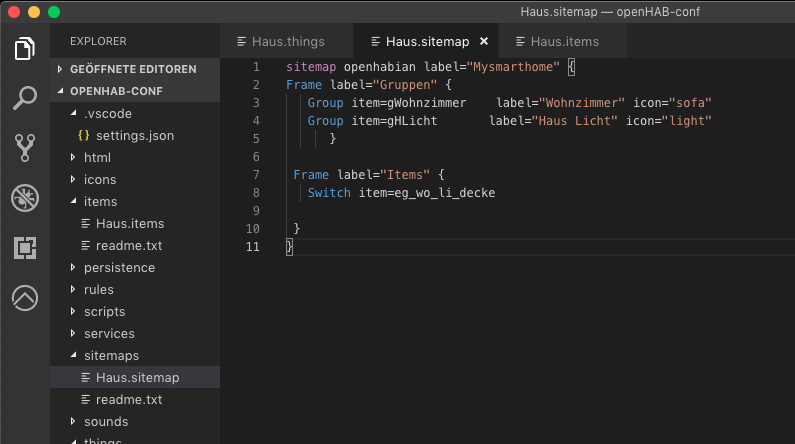

here can you see what i already wrote on Visual Studio Code, i as already, im new to the OH and Raspberry pi, any tips ? shall i do more screens from specific area?

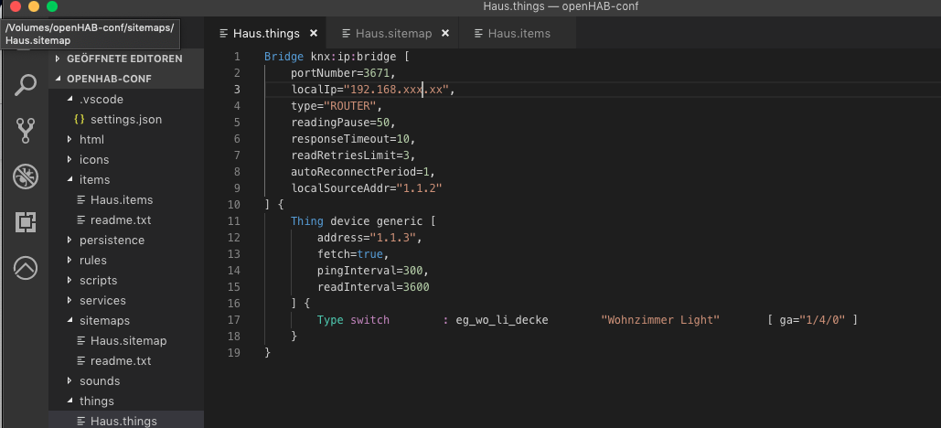

I just had a look on your IP interface and actor definition, seems there is an error with it:
The IP address of the IP router itself is not specified, only the local IP (your openHAB server).
Try something like this:
Bridge knx:ip:bridge1 “KNX IP Interface” @ “Somewhere”[
ipAddress=“xxx.xxx.xxx.xxx”,
portNumber=3671,
localIp=“yyy.yyy.yyy.yyy”,
type=“TUNNEL”,
readingPause=50,
responseTimeout=10,
readRetriesLimit=3,
autoReconnectPeriod=1,
localSourceAddr=“0.0.0”
Please adjust:
xxx.xxx.xxx.xxx: The IP address of your IP Router
yyy.yyy.yyy.yyy: The IP address of your OH server
Please enter 0.0.0 as local source address
An example for a tiny single-channel switch actor (there was an error as well):
Thing device Schaltaktor_1_1_4 “Schaltaktor” @ “Somewhere else”[
address=“1.1.4”,
fetch=false,
pingInterval=300,
readInterval=3600,
vendor=“ACME”
Channels:
Type switch : A “Deckenlicht WZ” [ ga=“1/2/10+<10/2/10”]
See the “A” ? You have to give your channel an ID !
The knx device address is 1.1.4. I set “fetch” to false as I had some devices that did not work well with it.
The group addresses here are:
1/2/10: The switch object,
10/2/10:The status object of the switch.
Values will differ for you, but you get the idea I guess.
You could then link the channel to an item like this:
Switch EG_WZ_Deckenlicht “Deckenlicht Wohnzimmer” (gWZ, gLighting) [ “Lighting” ] {channel=“knx:device:bridge1:Schaltaktor_1_1_4:A”}
Check to bold parts ,this should give you an idea how everything links together.
Hopefully I did not make any typos…
Good luck :wink:
