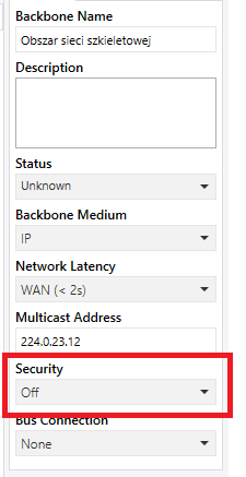

hi,
thx for quick feedback and advices,
finally i found solution to get access to X1, I have changed security level under ETS to OFF(before AUTOMATIC):
so now I can switch one lamp from openHAB :slight_smile:

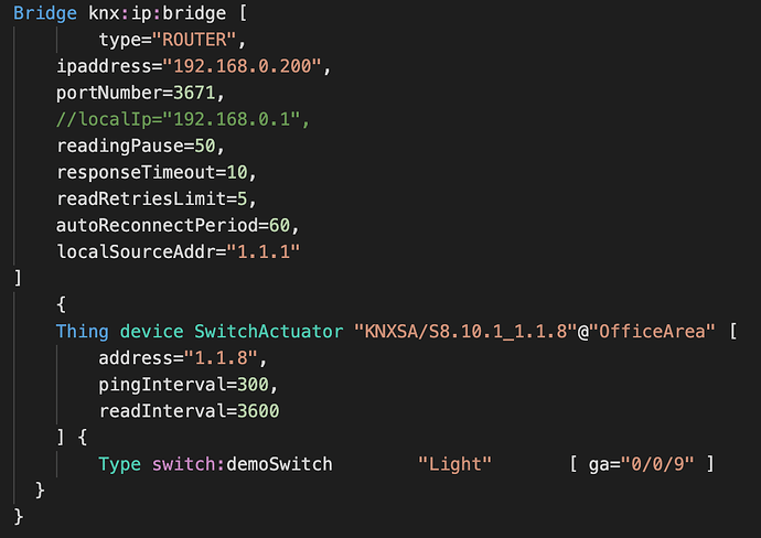

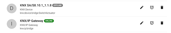

I am having the same problem of device being offline while IP gateway is online.
Also, I have got the IP Gateway to be online with lot of trial and errors.
Bridge knx:ip:bridge [
type=“ROUTER”,
ipaddress=“192.168.0.200”,
portNumber=3671,
localIp=“192.168.0.1”,
readingPause=50,
responseTimeout=10,
readRetriesLimit=5,
autoReconnectPeriod=60,
localSourceAddr=“1.1.1” ]
Thing device SwitchActuator “KNXSA/S8.10.1_1.1.8”@“OfficeArea” [
address=“1.1.8”,
fetch=true,
pingInterval=300,
readInterval=3600
Type switch:demoSwitch “Light” [ ga=“0/0/9” ]
Is there anyway to debug the situation what has gone wrong. I am unable to make out much from the debug information in the terminal.

Thanks rossko I have sort of got this working earlier. I am unsure if I was using an IPR/S. however, right now I am using ABB IPS/S .
While I have the configuration of bridge as below. 192.168.0.200 is the IP address of my IP Gateway and please note IP gateway is shown as online. My issue is with the Actuator.

I have been able to get this working.
I followed the other thread. Gateway online
While, in the above configuration if I remove the address (I consider this to be physical address) 1.1.8 which is my actual PA for Switch actuator, it works !
