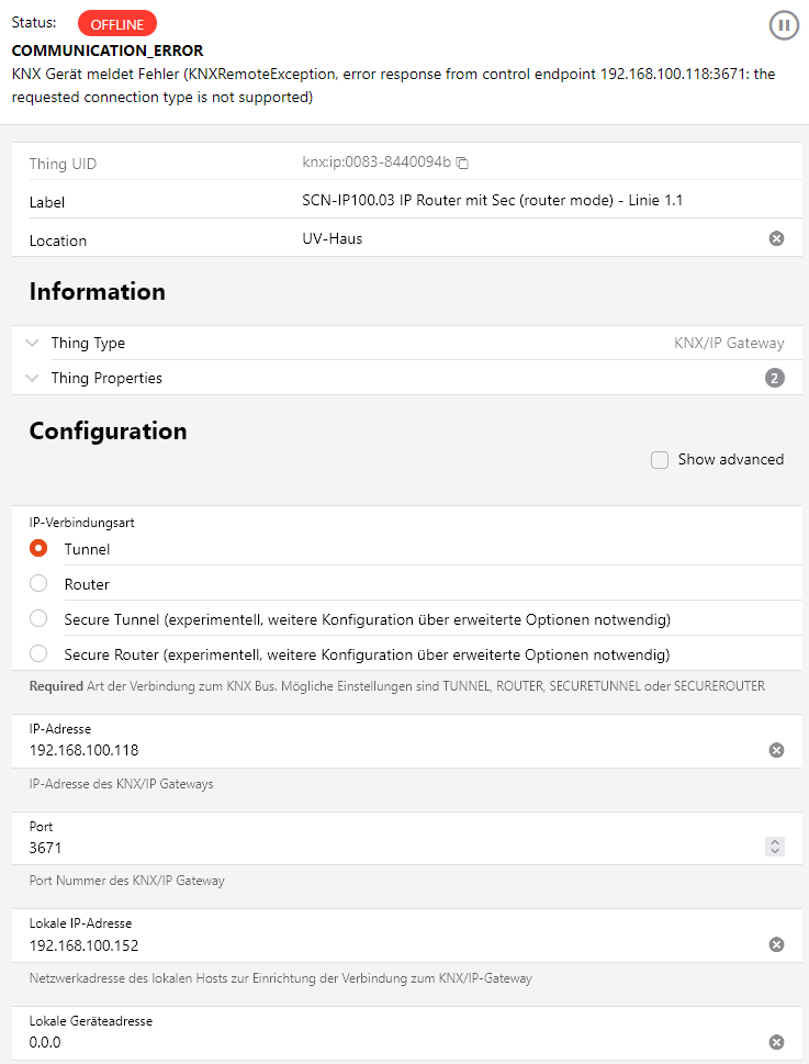

So far my knx test installation with currently 2 MDT IP-Routers (SCN-IP100.03) commisoned as secure by ETS 6 works properly with OpenHAB 5.0. Setup in OH is as shown in subsequent screenshots.
The “only” issue I have is, that during restart of OH, the configuration of the IP-Gateways switches automatically from “secure router” to “router”! (2 identical IP-Routers for two Knx-lines are installed and act as Routers with IP-backbone). Sometimes also the broadcast address is changing to the address of the router itself. As a consequence, all installed knx devices will stay offline as no secure communication is possible. After manual switching back to “secure router” and correcing the broadcast address, the system works properly again until next restart.
Has someone an idea what could be the reason for this effect and what has to be changed to get that solved?

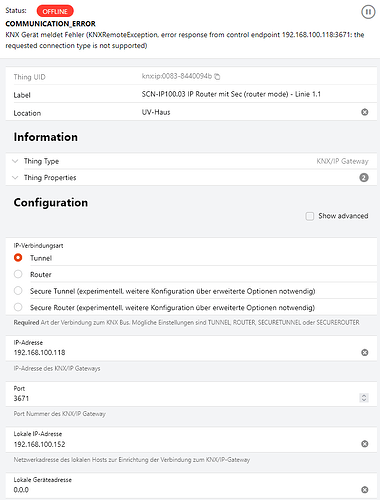

I have now made a trial with the latest 5.1.0 snapshot, but w/o any difference. After restart the configuration for the MDT IP router changes to following parameters:

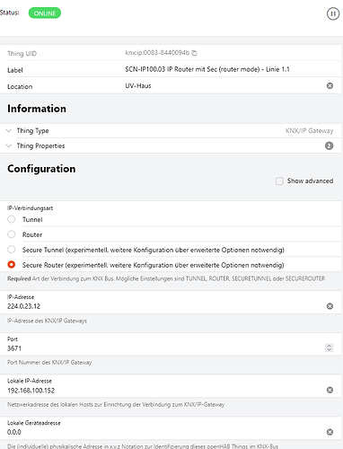

While before restart it was set to following:

I have a similar behaviour, my Thing for the MDT Interface is jumping from Tunnel to Router. AFAIR others have mentioned this issue before.
My impression is that maybe some kind of auto discovery overwrites the settings of the already existing thing.
Effect is that after some days I loose the connection to the bus as the Router uses some multicast address, replacing the Tunnel setting and the IP address for the interface.
Don’t remember the exact release but afair it started some months ago. Maybe switching to text based config would prevent it, but I did not want to reconfigure all my knx Things to talk to the new IP Interface thing.
Thanks @Oggerschummer, the autodiscovery of the binding seems to cause the issue (not the addon-finder!).
Thanks @kdmsch for bringing this up again! This can be fixed for the 5.1 release next week.
Ref:
A fix for that has been integrated now (part of 5.1 RC2), and will be part of the upcoming 5.1 release.
If we do a patch release for the older series, I will add it there as well.
