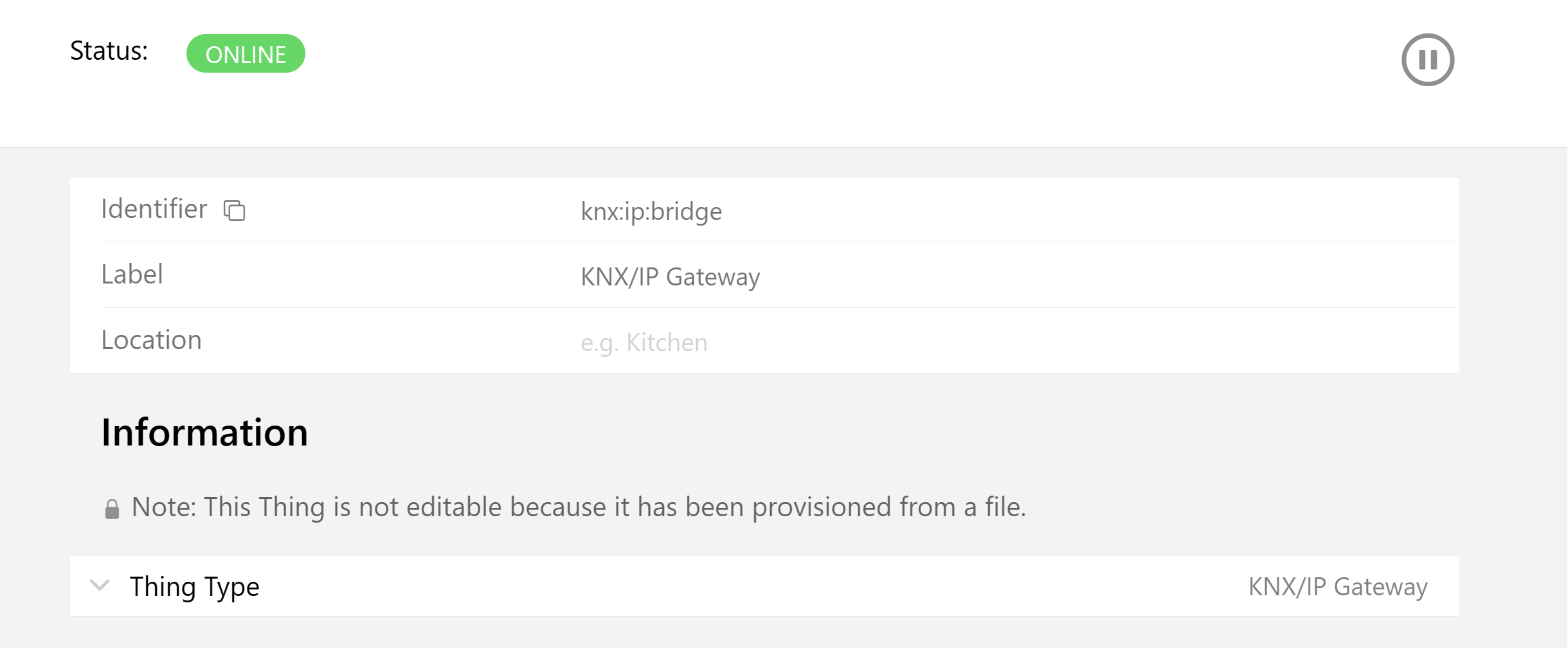

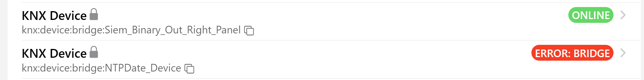

The KNX thing I created shows a bridge offline error, while the used bridge is online and other things that use the same KNX bridge are online.

The KNX thing configuration:
Thing device NTPDate_Device [
fetch=false
Type datetime-control : knxDateTime "KNX DateTimeWrapper" [ ga="10.001:0/1/200" ]
The KNX bridge configuration:
```yaml
Bridge knx:ip:bridge [
//ipAddress="192.168.2.100",
localSourceAddr="9.0.0",
type="TUNNEL"
,ipAddress="127.0.0.1"
,responseTimeout=1000
,readRetriesLimit=10
,autoReconnectPeriod=90
