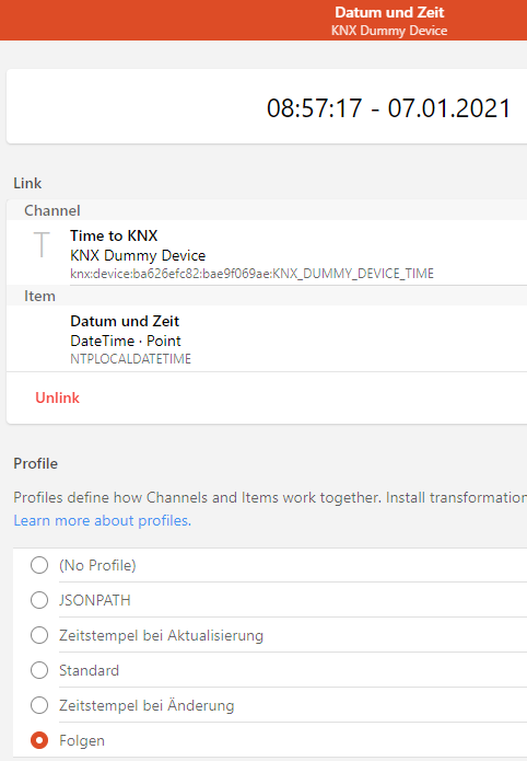

Then created an item linked to the NTP things local time.
After this linked the same item to the KNX time channel of the “KNX DateTime Wrapper”, but with the “follow” profile.
Bildschirmfoto 2021-01-06 um 23.43.13
Each time the NTP local time changes, it updates the linked item. As the second channel (the knx time item) is linked with the profile “Follow”, it takes over the change from the first channel - this results in the time being written to the bus.
The group addresses for you will differ, but the concept should be clear I hope.

@gpowa : You could link both date and time GA to the same item (with the ‘follow’ profile):
i hope this helps

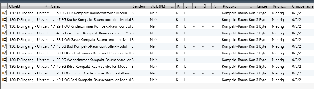

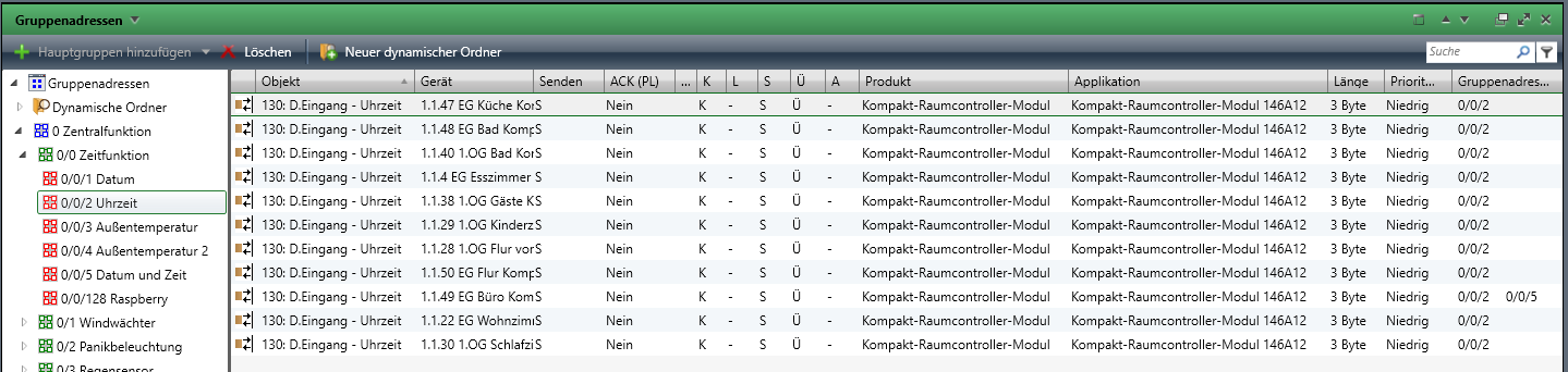

All this put aside, how is your GA defined (0/0/5 and 6/0/1 at least). I got the suspicion one of them is set to “S”(end), so what happens is:
  1. you update the time from openHAB
  2. one GA gets updated AND sends the time and as this triggers openHAB to update also, this loops

Hello binderth,
thanks for your advice, next time i use fences. So here is my config in ETS:
grafik
grafik

Judging from your ETS-screenshot you have your KNX switches/buttons all configured to “Ü”(bertragen=send) the time. I do think THAT is the loop, your looking for, because every single one of them will send the read-out value again to the Bus.
Simply put: you’ll send the time to 0//0/2, all your buttons read the time and at the same time send the time.
Try to remove the “Ü” flags.
You are right, that seems to be the reason I´d say.
OH is fine, its a misconfiguration in the knx - either the Raumcontroller receives the date/time from the bus or it is generating a time signal and provides it for others. Both together makes no sense.

Did you remove the Ü-Flags from all(!) the devices where this group address is linked ? They all react to the update they receive from the bus…

so i try and change from Write “S” to Read “L” in the ETS but the same loop.
grafik
please start the Busmonitor in ETS and set the Filter to “0/0/2” and see what happens.
