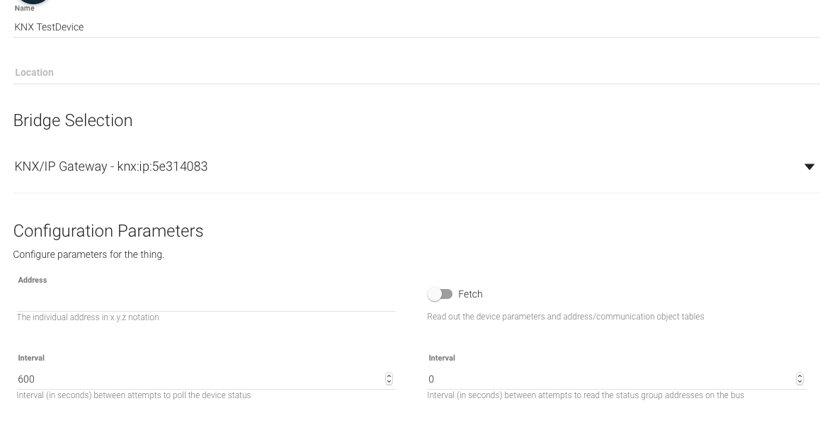

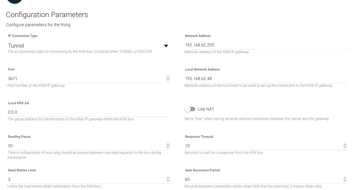

  5. in Paper UI, setup my knx IP bridge and one device, setup one dimmer channel and one linked item.

Yes, thanks, at least it brought some light in it. After changing the definition, my dimmer started working again. My perceptions so far:

I really need your help. Really in urgent case I struggle with this message:
None of the configured GAs on channel 'knx:device:71cd6426:sdsds' could handle the command 'UP' of type 'UpDownType'
Happens with everything I want to “control” by openHAB towards KNX.
I am totally new to KNX and it is really frustrating.
I am using this config:

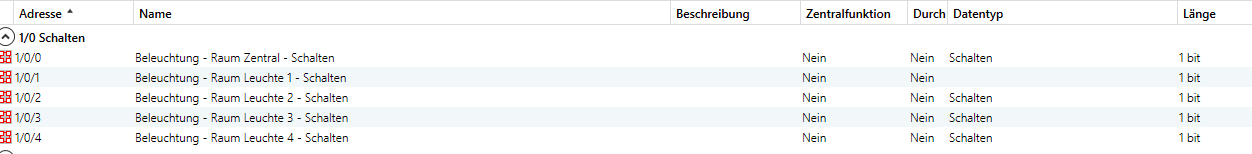

Do you have access to the ETS project? Are the GAs’ DPTs correct?
Normally the error message appears when the GA DPT is not matched to the ga configured in openHAB! Can you please post the thing and channel configuration?
What’s your Thing configuration?

@Udo_Hartmann @george.erhan @Dim
here is my thing:
and
I want to control these KNX devices:
Textual:

Please delete the ga= part and the quotation marks.
I removed it and still getting this mapping problem:

Can you monitor the bus from ETS (don’t think you will get anything at this moment, but it worths a try)? Does openHAB report when starting as being connected to the KNX bus?
What type of KNX/IP interface (producer/model) do you have there?
Does the interface allow multiple tunelling connections, or is it a KNX/IP router that can be used as tunnel as well?
Try removing the DPT definition first from the configuration of the channel (1.001 in this case), leave only the GA, restart the binding or openHAB, check for the startup log that openHAB connects to the KNX bus in tunneling mode.
It is a GIRA KNX/IP Gateway and is already in TUNEL mode:

That’s good. I am almost sure the problem lies in your openHAB configuration of the channels.
Try using the config files and not paper UI to define the ga’s (I have never used Paper UI for KNX), and I’m sure it should work from the config files.
Looking at your json files for the thing configuration it doesn’t seem that something is wrong, but still it’s worth trying to use the textual configuration. @Dim has provided a nicely structured knx.things configuration file.
In your case, define the thing with the channel like this:
