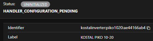

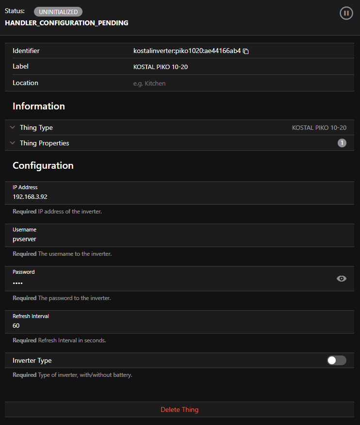

For me it still is not working.
Even with prefix http://
Thing code:
UID: kostalinverter:piko1020:ae44166ab4
label: KOSTAL PIKO 10-20
thingTypeUID: kostalinverter:piko1020
configuration:
  password: ...
  refreshInterval: 60
  url: http://192.168.3.92
  username: pvserver

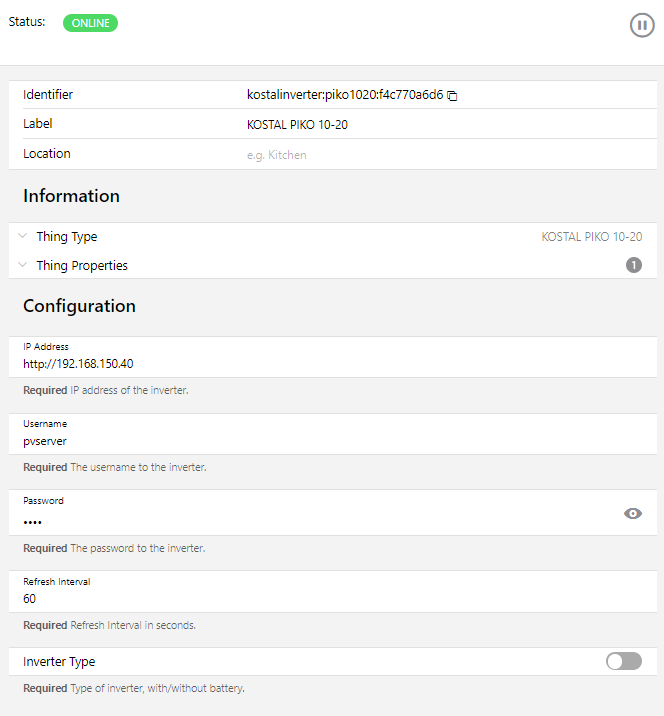

I have a Pico 10 second generation with the green panel.
and I use this settings:
and ist works good.
I did every settings in the new Webgui
This response is working fine.

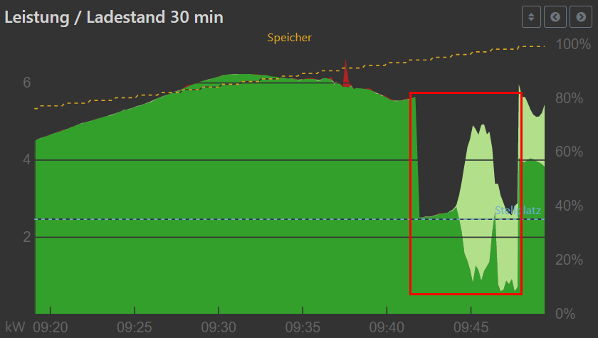

I think there must be a way to read the data properly (without blocking aditional requests), because openWB for example is able to read from the inverter. If openWB read the data, I can still open the website from the inverter or call the API above via browser.
Addational info:
You can see directly in openWB, whenever the HTTP-thing is activated (to be clear, in that case even openWB cannot read data).
I only can read the data from my 1st inverter (plenticore).

Correct, that does not work. It does not switch to “Online”
It seems to work for @civilnote , but the difference in my setup is an openWB that also reads data from the PIKO and a second inverter plenticore which is read by the same KOSTAL binding.
