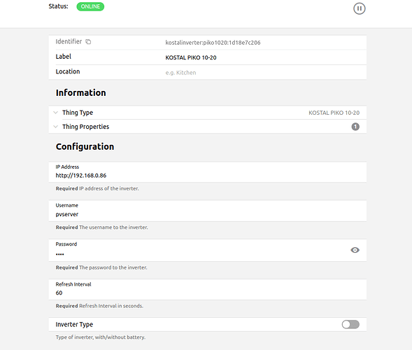

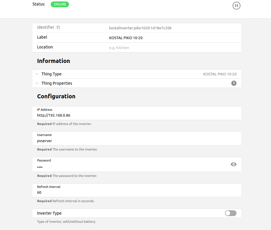

Please have a look at Main-UI / Things / Kostal Piko 10-20 / Thing / Inverter Type and let me know if this parameter is required or not in your configuration-page!

Are you sure that this is a inverter of 1st generation, regarded to the name should it be an 2’nd generation inverter?
If so, shall you use the Kostal 10-20 part of inverter and configuration as: ( mine is without battery, so just Please try with Inverter Type with battery )
