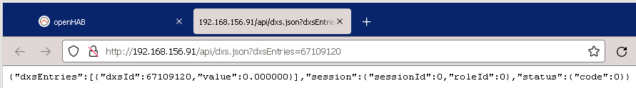

You can try to http://192.168.0.xx/api/dxs.json?dxsEntries=67109120 in a Web -browser just to check that the inverter answers as {“dxsEntries”:[{“dxsId”:67109120,“value”:0.000000}],“session”:{“sessionId”:0,“roleId”:0},“status”:{“code”:0}} or something similar
I use to install it in The GUI, maybe you have to clean the config files and reinstall, but first delete all Thing and channels.
I am quit shure that you have done all these things already, but if it possible to get data as above from the inverter, must there be something that got stucked.
I just saw your latest info. I am just running 3.2.0 on an raspberry
But first try to connect to the inverter as above and check, and maybe even restart the inverter, you have then to disconnect the power to the inverter to have the Inverter Web-server to reboot.
I think i get the correct response.
From my PC:
And from the openhab virtual machine in the terminal:
$ lynx http://192.168.156.91/api/dxs.json?dxsEntries=67109120
{"dxsEntries":[{"dxsId":67109120,"value":0.000000}],"session":{"sessionId":0,"roleId":0},"status":{"code":0}}

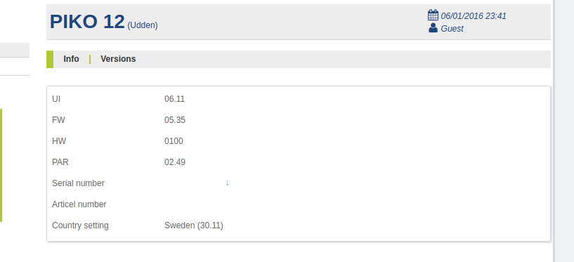

Which FW and UI version do you have on the Piko 15?
Maybe it has something to do with it?
My infos page:

My inverter is like:
BR Basse
