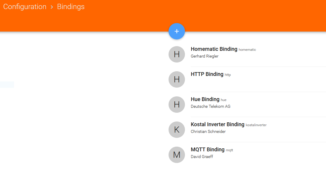

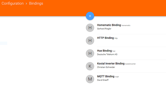

Did you install the HTTP binding?
No, I just installed the Kostal Inverter Binding (binding-kostalinverter - 2.5.4).
Is the HTTP binding necessary?
Necessary? Not sure, I do not use the Kostal binding, but I would install the HTTP binding and see as the error is HTTP comm issue. :thinking:
Installed the HTTP Binding, still the same error :frowning:
