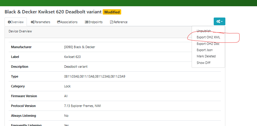

For future reference (if an existing XML is not available), use the gear icon for OH2 XML in the smarthouse DB and copy paste from the window that opens up into the correct file name on your local machine. It is not formatted very well but will work.
I did that, but I hit Ctrl-A and the browser selected more than just the text box, so I got part of the page header and footer on my clipboard.
