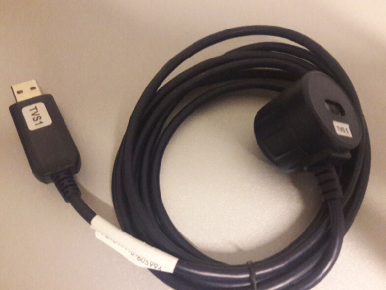

I found this IR to USB in the net which would suite to my Landis & Gyr E350.

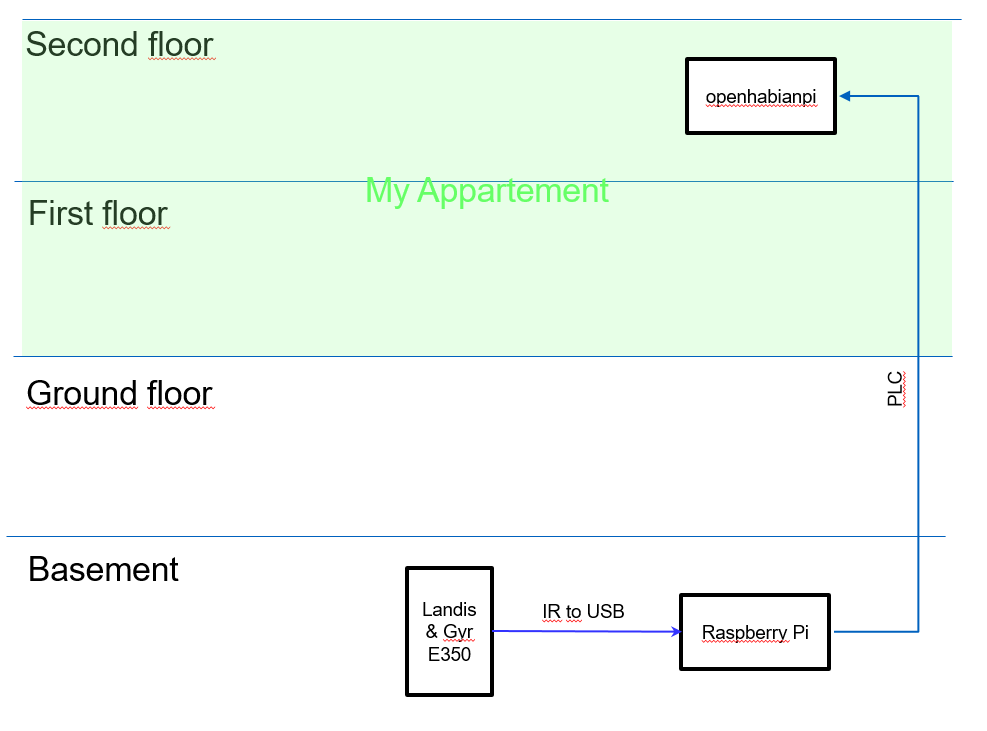

I have the following solution in mind.
The question is how do I bring the data from the basement raspberry to my openhabianpi in my appartement. There is no WIFI Signal from my apartment in the basement. That’s the reason why I was thinking about using a second raspberry pi in the basement connected with the IR to USB cable and then send the data somehow to my openhabianpi on the second floor in my apartement.
Any advice is welcome.
Thank you very much.
Manuel

Let my try it this way. The rasp in the basement should act as a proxy and send its data to the openhabianpi in my apartment.
Let me think loud.
If I also install openhabianpi on the rasp in the basement and use EC 62056-21 Meter Binding to read out the data from the Landis & Gyr E350 using the IR to USB interface. Can I then send the data to my openhabianpi in my apartment? The openhabianpi in the basement should act like a proxy. That is my idea.
Greetings Manuel
Yes it is, then we can decide what hardware to use to read your meter and send the data.
Yes but how?

The easiest medium for me between basement rasp and openhabianpi would be with two Powerline Adapter. There is no chance to lay a new cable.
Manuel
Right. So you would have access to your LAN in the basement.
A pi connected to your LAN can convert your data from your meter to MQTT with a python script running as a service. Done
Thank you Vincent for your patience. Would it also be possible to install openhab on the pi in the basement, use the IEC 62056-21 Meter Binding and forward all data via LAN to my master openhab instance in my apartment? This way I don’t have to write a python script by myself which I’m unfortunately not able to do.
Manuel
Yes
Have a go, it might turn out to be fun
But how can I forward messages from one openhab to a second master openhab instance?
Manuel
Multiple choices there, but searching this forum for “MQTT event bus” will give you starting ideas.
This is an overkill approach.
