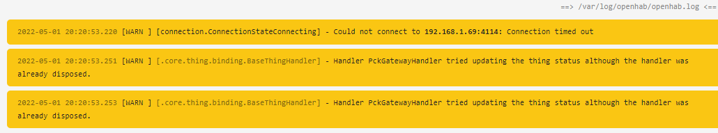

But get warnings in the logfile:
The logfile shows no item state change Events from the modules
Here i see that the old IP is somewhere used from the openhab Base thing handler
The question is now how can i get rid of this failure.
