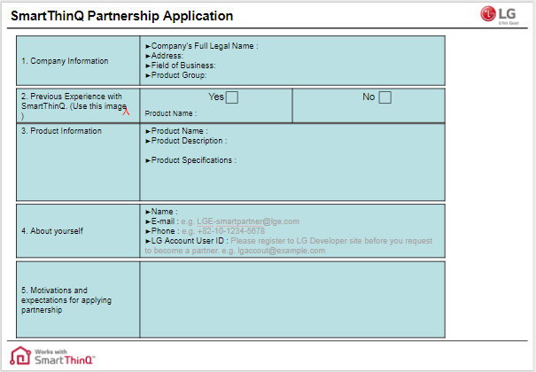

Well I thought getting the API key would be easy but it turns out you have to APPLY to become a partner which sounds a little crazy
http://thinq.developer.lge.com/en/discover/partnership/#Partnership%20Request
SmarThinQ%20Partnership%20Application
