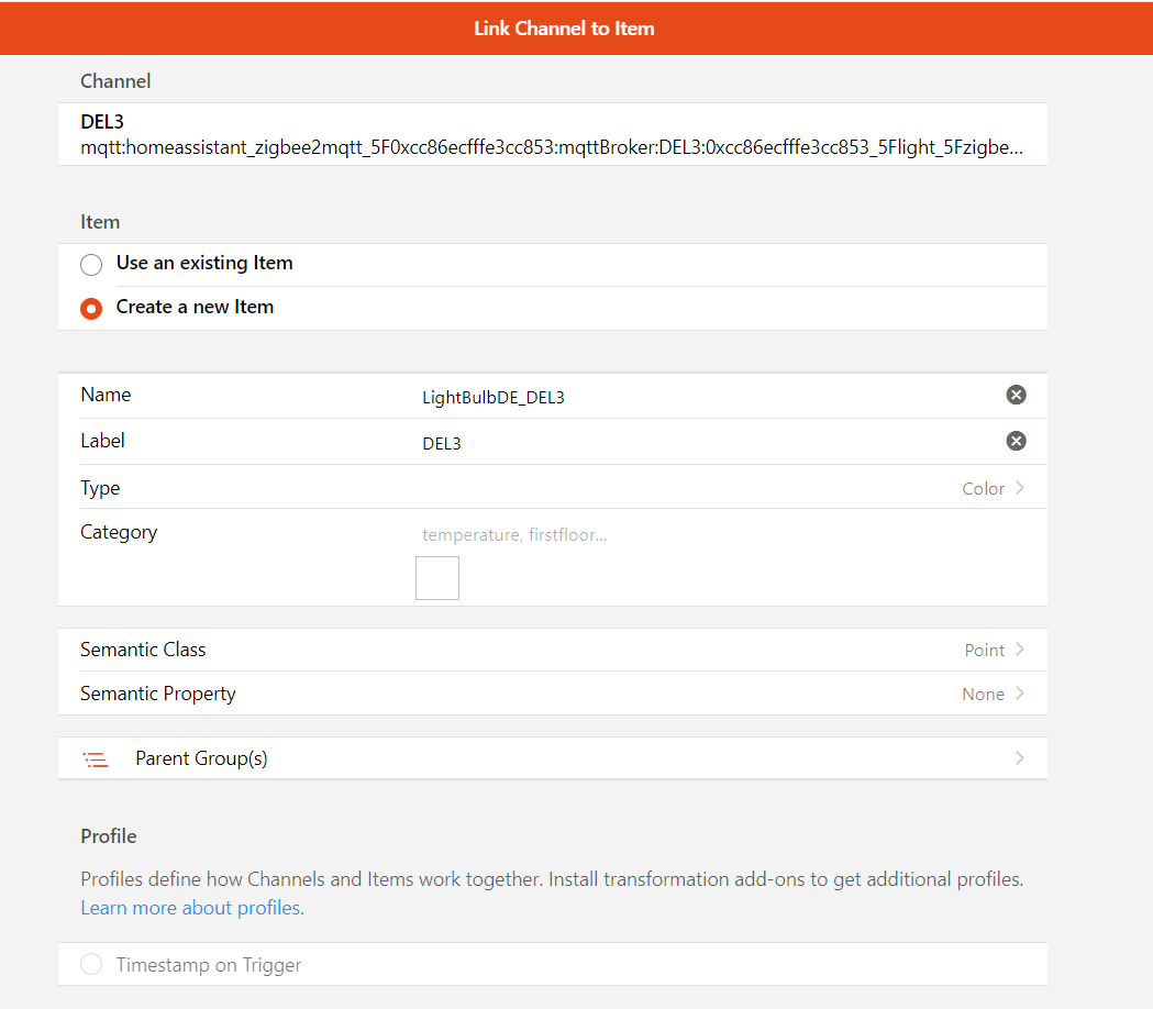

I cannot solve the problem of adding this device via zigbee2mqtt to openhab.

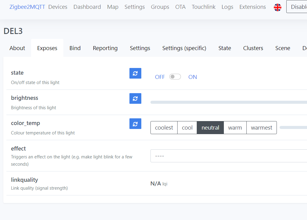

The devise exposes all kinds of topics:

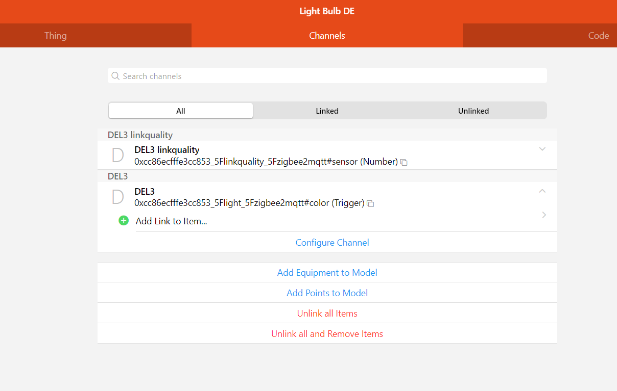

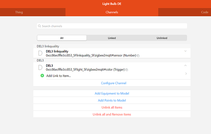

But once I create the z2m Thing it’s reduced to one channel for the link quality and one (Trigger ???) channel for Color:
So far, so surprising.

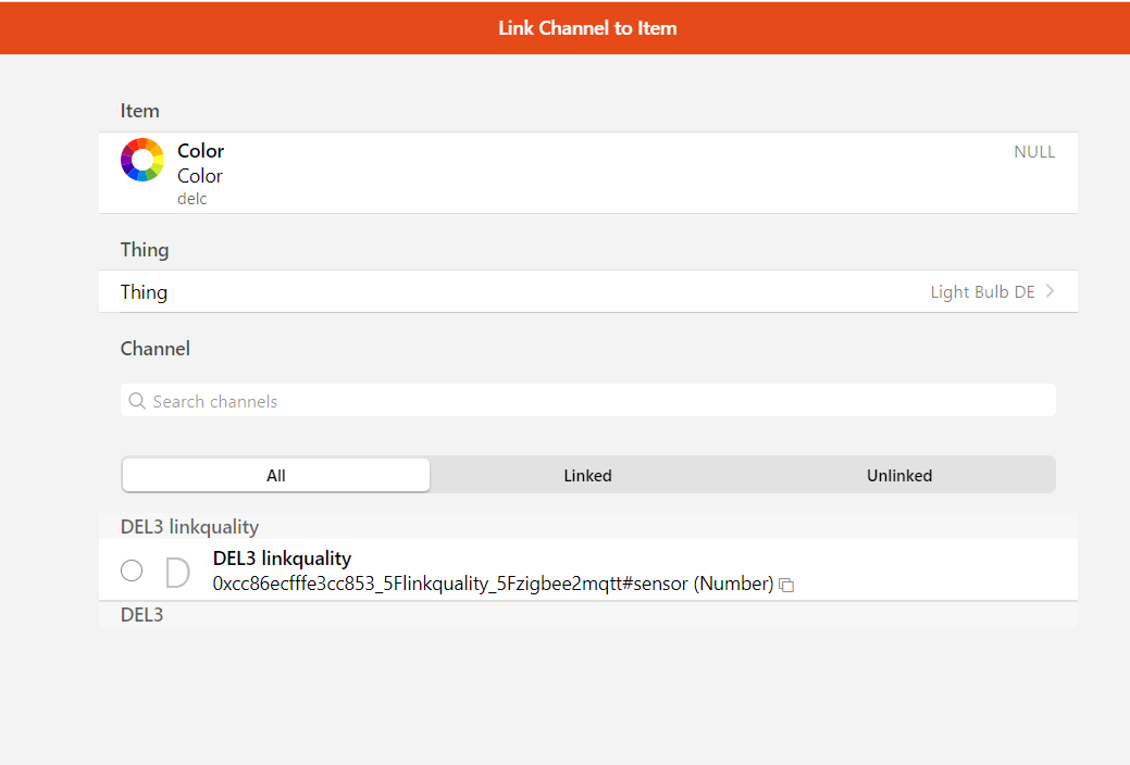

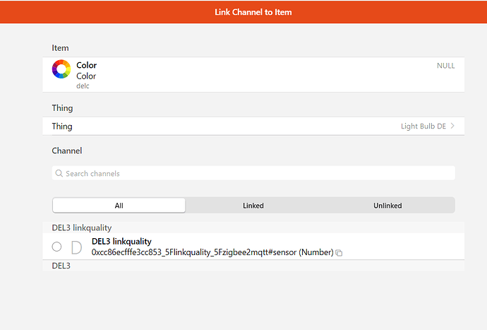

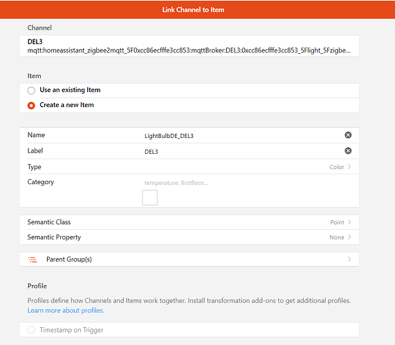

However, I cannot create any item based on that trigger channel, as - for starters - there is no selectable profile.
Not even sure, how the trigger channel would actually do all the switching, dimming and color changing, as creating the Itemfirst and the trying to link it back to the trigger channel, doesn’t work neither.
Any help?
