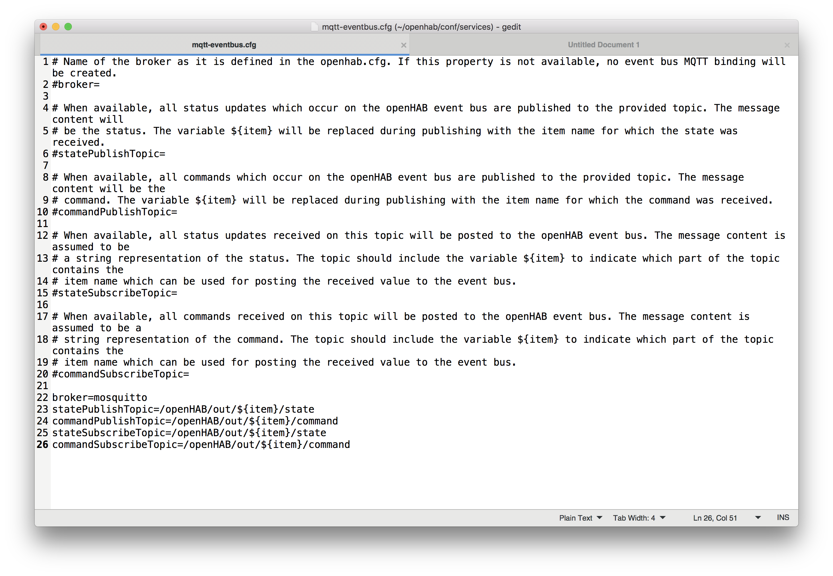

Now, when I change the brightness the following occurs where “LIFX22E22D_Color” is configured from the configuration file ‘/conf/services/mqtt-eventbus.cfg’ using “${item}” as suggested here: https://docs.openhab.org/addons/bindings/mqtt1/readme.html

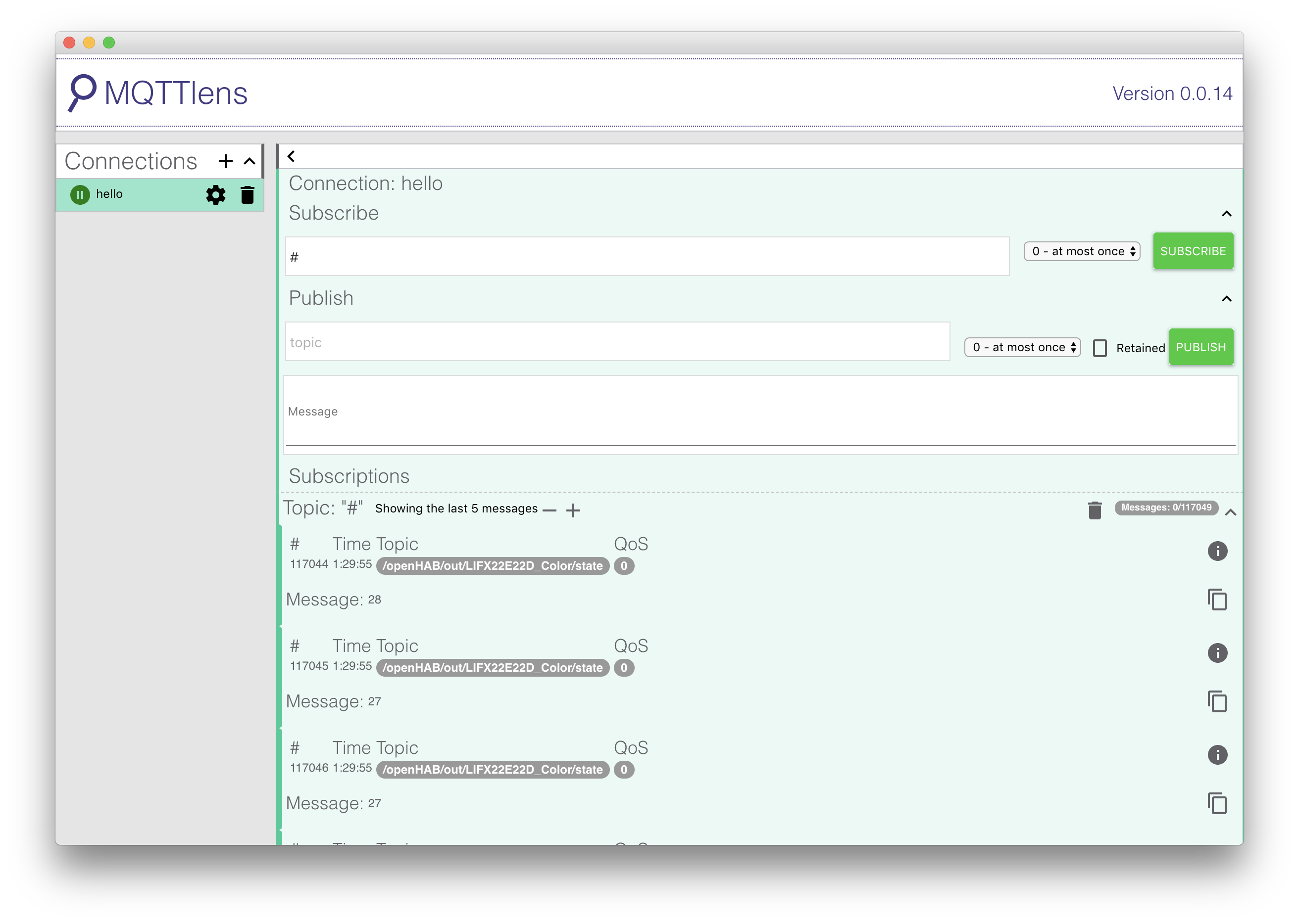

  1. I used the PaperUI to set the brightness one time to somewhere between 25-30%.
  2. In the MQTTLens application, I can see OpenHAB send out requests to set the brightness level to 27 and then to 28% back and forth forever until I “logout” of the OpenHAB runtime.
    2a. This leads to hundreds of thousands of messages really fast and hinders my OpenHAB runtime from operating in a reasonable amount of time.
Please attachment to see the effects of changing brightness of LifX bulb just one time.

Note: The offending bulb(s) only flicker if I play with their settings within this instance of the OpenHAB runtime. It appears to continue until I bring down the whole runtime and restart it.43%20PM

When posting textual information such as configurations, never post an image. It’s useless. Paste the text itself or attach it as a file.
If pasting, place the pasted text between code fences.
The MQTT configuration is hardly of importance here. How do I find out who can help me with bugs in the LifX binding?

I have found the culprit. I guess I’ve never successfully removed MQTT as a binding when I “pared” back the problem.
There was a feedback loop in my MQTT configuration. Which goes to prove I should’ve kept with the MQTT configurations earlier.
I was able to remove the MQTT binding in the Paper UI, then only set it in <openhab>/conf/services/addons.cfg. I was able to verify whether MQTT binding was installed or not through review of logs. I issued the following command in the OpenHAB runtime to view the logs and verify binding states:
openhab> log:display
I hope others don’t make the same mistake of subscribing and publishing to the same topic in their MQTT configuration(s). For those interested, this is the WRONG configuration for “<openhab>/conf/services/mqtt-eventbus.cfg”:
broker=mosquitto
statePublishTopic=/openHAB/out/${item}/state
commandPublishTopic=/openHAB/out/${item}/command
stateSubscribeTopic=/openHAB/**out**/${item}/state
commandSubscribeTopic=/openHAB/**out**/${item}/command
And this would be an example of a valid version:
broker=mosquitto
stateSubscribeTopic=/openHAB/**in**/${item}/state
commandSubscribeTopic=/openHAB/**in**/${item}/command
