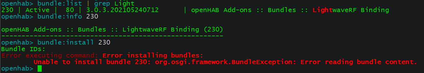

try this @integrator : openhab-lightwaverf-compiled/org.openhab.binding.lightwaverf-3.0.3-SNAPSHOT_3.10.jar at main · delid4ve/openhab-lightwaverf-compiled · GitHub

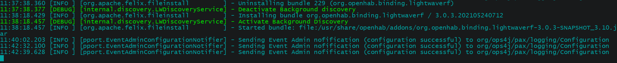

Not sure if I’m doing something wrong, but still isn’t working… looks to be installing, but nothing shows in the UI.
Had to reply twice as I’m a new user:
Scratch that!
I’ve just realised I was looking in the wrong place… I was expecting to find the Lightwave binding in the ‘bindings’ page, but I have just discovered it in the list of things that can be added manually. I entered my login credentials and it’s showing as online. Now on to have fun to figure out how to pull the individual properties to be actual light switches.
You just got to go to Things → + → lightwaverf → scan
You can then click add all
Then you can go to each thing and select channel tab and add what you need
And yes custom bindings don’t show up, just under things as you have now discovered.
