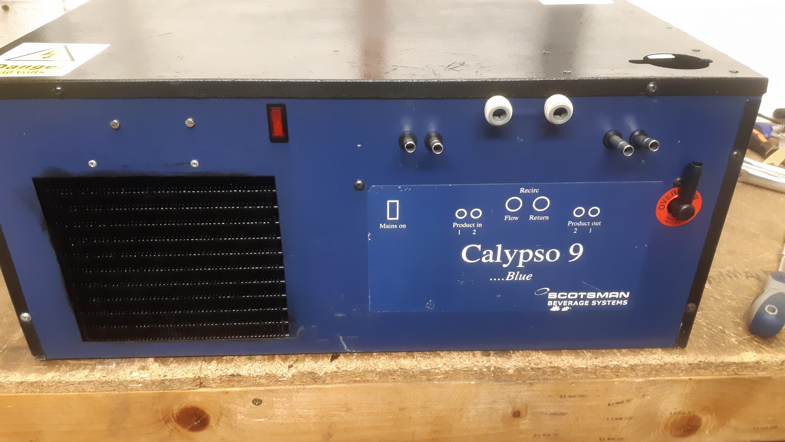

off topic, refrigeration Ive a beer chiller rig ( brewpi monitored, openhab gui ) that only chills when the motor is cool, does it need re gas ing ?

Send me a pic of the back of the unit so I can see the setup (there’s many different types)

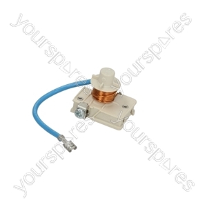

Could be the actual compressor relay (about £20), sounds like it’s not switching over to run when it’s hot and then the comp goes off on its internal thermal protection, common fault.

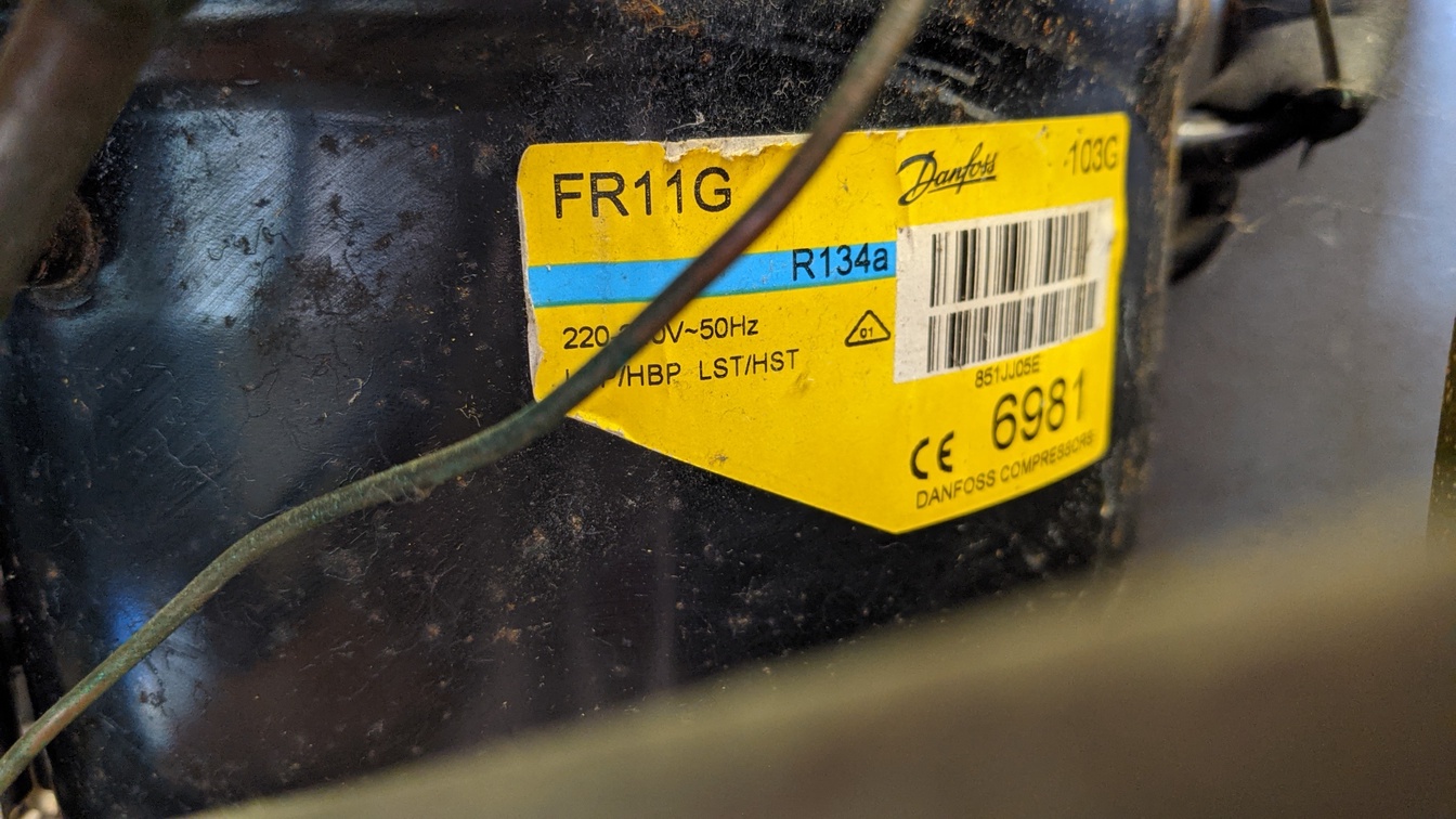

If you let me know the comp model I can get you a price on the relay

its all very clean, its a CALYPSO 9 beer chiller

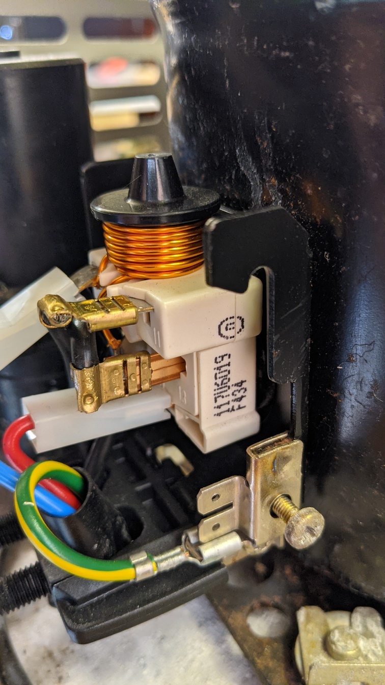

There must be a relay on the compressor, it has to have one unless 415v. Will be under black electric cover and will look something like this:
One of these? If so that black thing on the left is the condenser that needs to be clean
Yes of course, a starter & thermal ? , In a guess which mine always does trip off when its hot
had to add another relay for extra fans to try to cool it down. Bet you could suss it
Replace them both plus cap.
Photos of said internals.

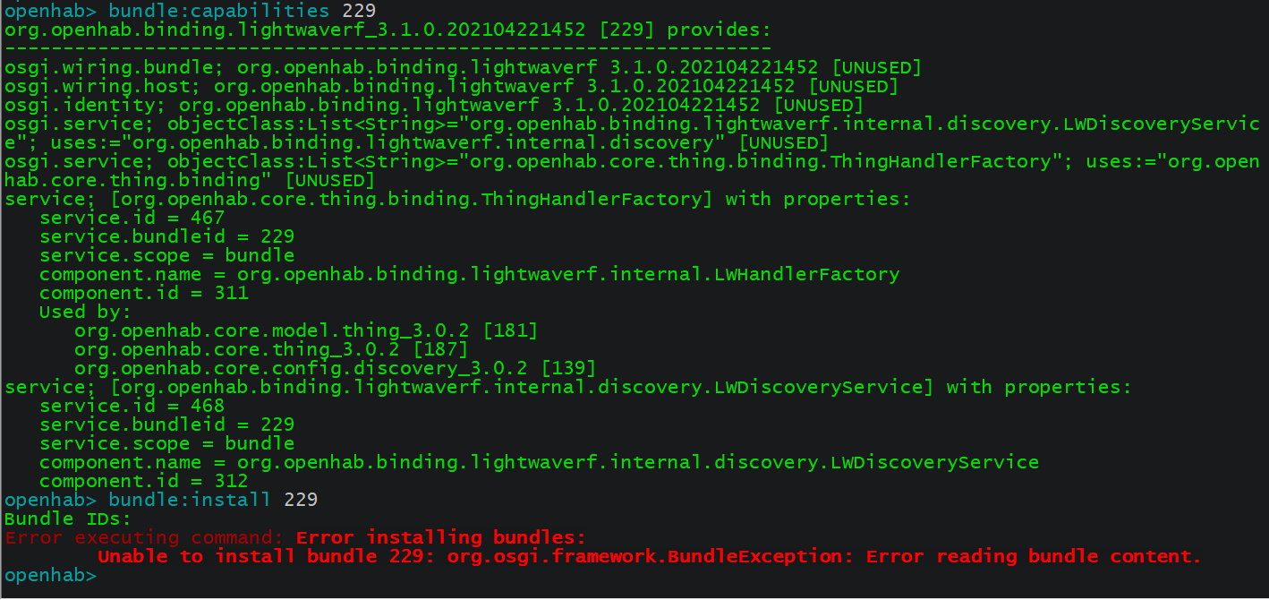

I’m running OpenHAB 3.0.2 as the latest release from the Debian stable repository. I downloaded the add-on version org.openhab.binding.lightwaverf-3.1.0-SNAPSHOT_3.10.jar as there doesn’t appear to be a match for 3.0.2. I placed the file in the add-on directory at /usr/share/openhab/addons/ and fixed permissions. If I set logs to debug I see OpenHAB pick up the file, install it, and it is listed on the console as an active binding. However it still doesn’t show in the UI.
Do I have to upgrade to the testing branch in order for this add-on to work, or am I getting something basic wrong?
I think I probably need to recompile for you as the build system all changed due to bintray closing. Can do tomorrow for you.

Is the problem due to me using 3.0.2 or something else? Genuinely curious.
Will this binding make it in to the official list?
Yeah I compiled before it’s release so won’t work (had same problem with my Sonoff binding)
