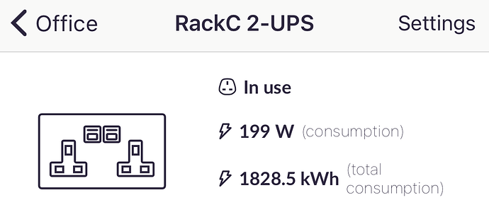

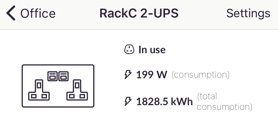

Just tested the ups also, have connected the POWR2 between the LW socket and the ups. I get 330W from POWR2, I get 305W as output from ups(i guess the 25W are for ups operation) and I get 205W from LW socket.
