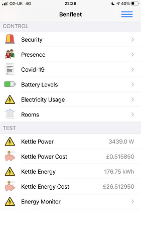

@pentiumdb does seem to be out (see below - Kettle) which makes it pretty pointless. I’ll do some more testing against my clamp meter and energy monitor over the weekend. Pee’d me off tbh as was one of the reasons I chose LW.

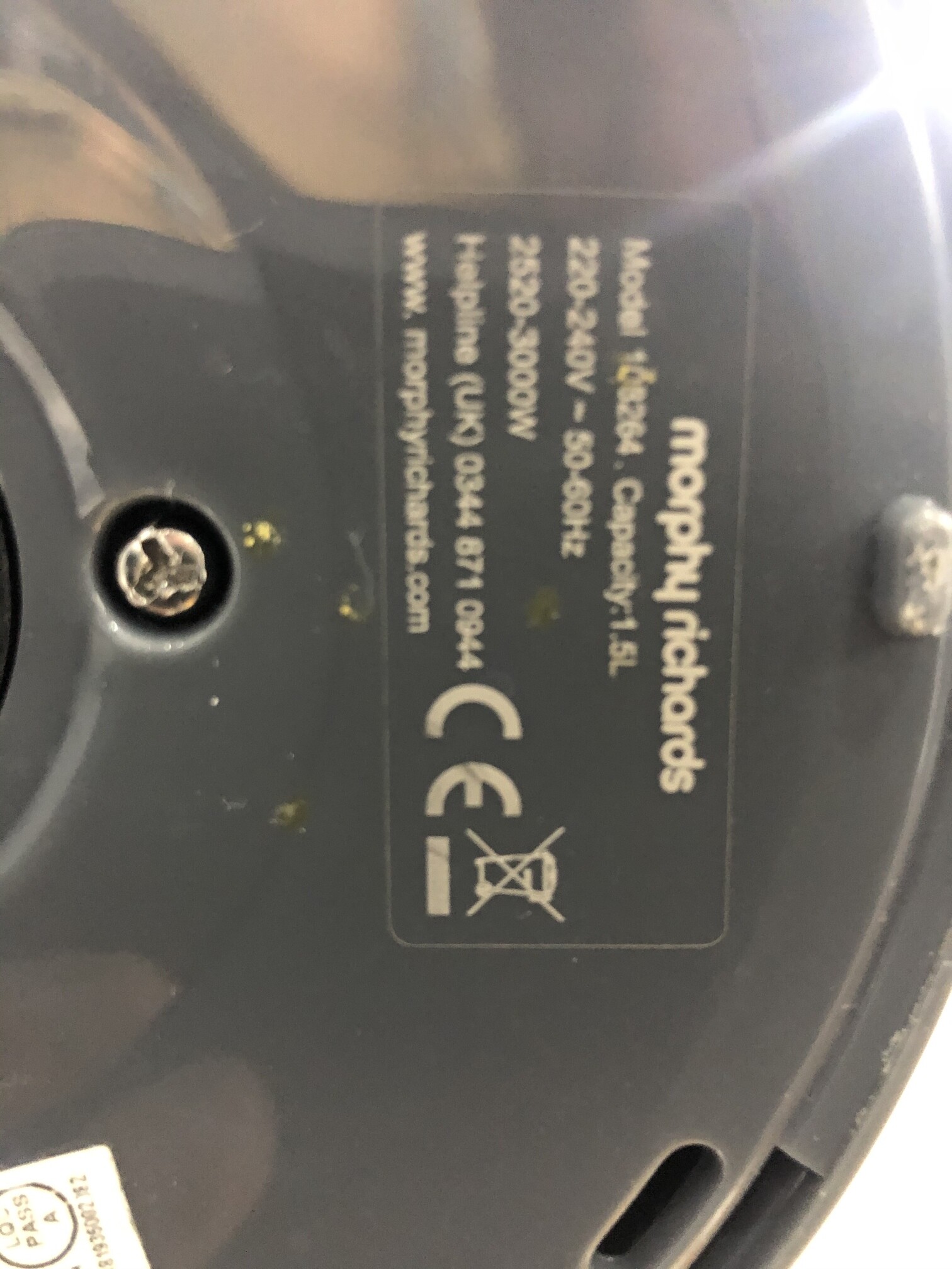

My kettle is a resistive load so from what they are saying this should be accurate (I understand capacitive/inductive won’t be) - And I would expect this to be accurate to at most 5%

Still.. 3500 / 240 (voltage normally there or there abouts) = 14.58 amp.. thats not right.
and even if the voltage is lower, amperage is going to increase.

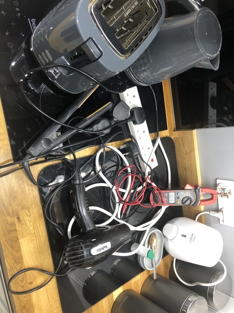

Tried again with the hairdyer on several sockets. My mains measurement always went up approx 2000W. The reading on several LW sockets was different. I got a range of 1030W to 1250W for the exact same load

So have run a few tests with various resistive load devices and the accuracy against my test meter is as follows:
@3000W LW 17.5% higher power
@1500W LW 17.5% higher power
@900W LW 19.2% higher power
@500W LW 22% higher power
