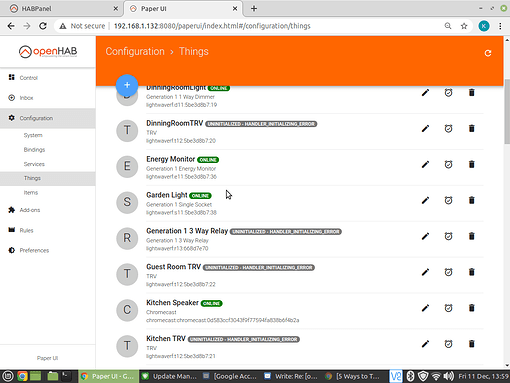

@KOTECH add this jar and let me know what happens for the relay - havnt tested as dont own but have integrated based on the commands you gave me. Its a string and you can send OPEN / CLOSE / STOP to it.

Added LW821 - 3 Way Relay - untested at present
Will do and let you know
Regards
Kevin
Hi Dave
Replaced old JAR for new and with the new JAR my previously working TRVs have now failed with then same message as the relay.
try clearing the cache and restarting.
