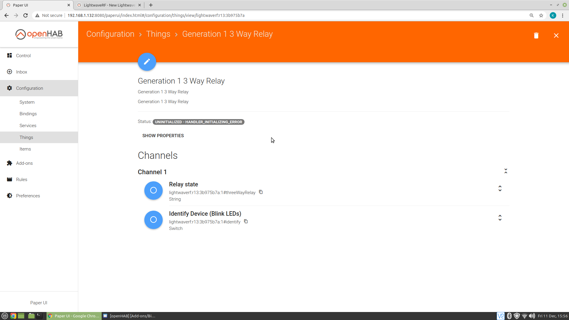

Ive just retried again and enclose the error messgae I have on the failed devices if I select the device in the “Things” tab. All are the same except for when I select the relay I just have error handler initiatilisation error
Status: UNINITIALIZED - HANDLER_INITIALIZING_ERROR class org.openhab.binding.lightwaverf.internal.handler.LWAccountHandler cannot be cast to class org.openhab.binding.lightwaverf.internal.handler.LWAccountHandler (org.openhab.binding.lightwaverf.internal.handler.LWAccountHandler is in unnamed module of loader org.eclipse.osgi.internal.loader.EquinoxClassLoader @38784a7; org.openhab.binding.lightwaverf.internal.handler.LWAccountHandler is in unnamed module of loader org.eclipse.osgi.internal.loader.EquinoxClassLoader @56924c11)

Try clearing the cache
Hi Dave the previous errors have now gone with clearing cache but relay still states initialisation error.

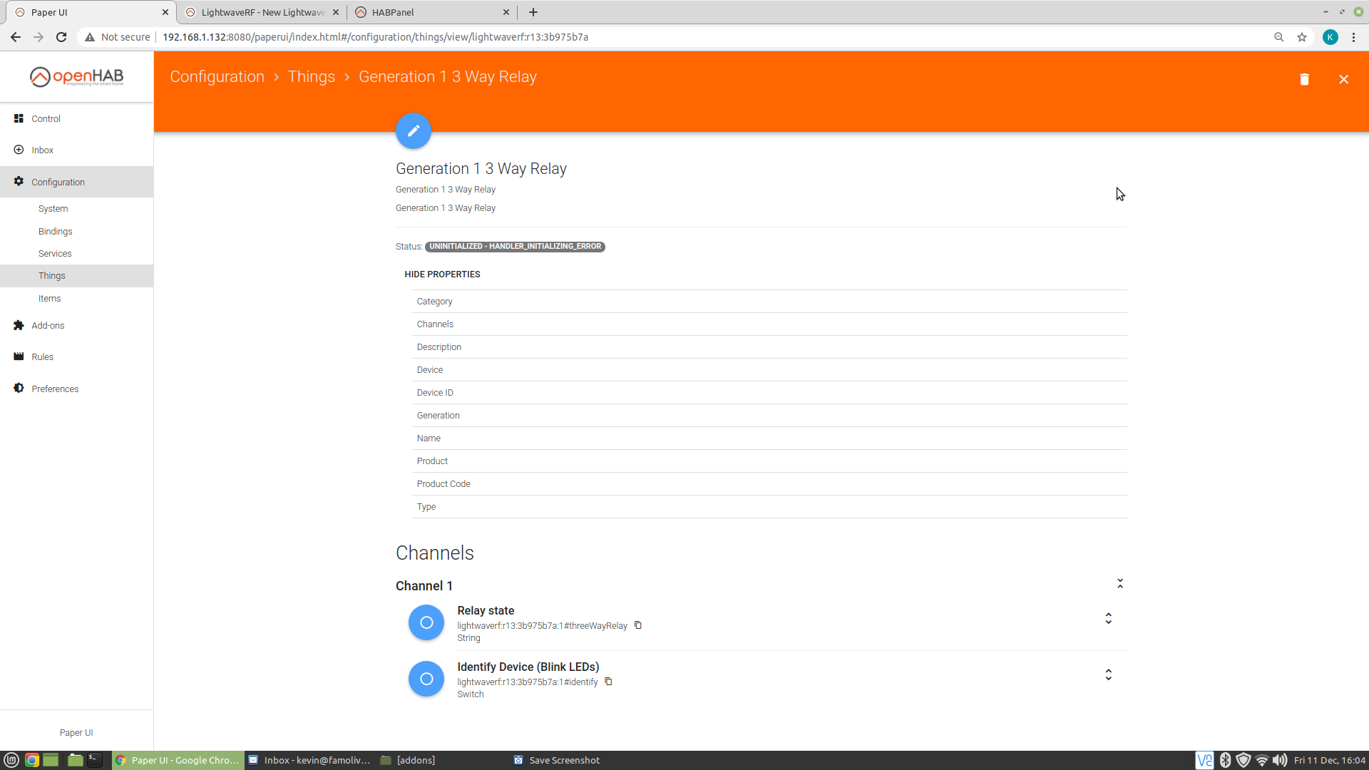

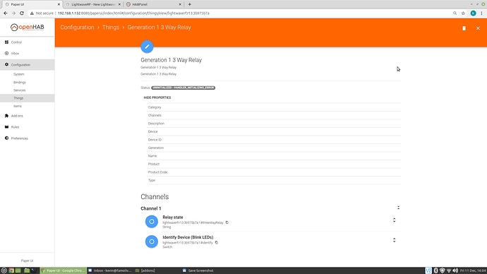

@KOTECH are you using discovery or files?
can you try removing and then rediscovery
and then also send me the ‘show properties’ section
Hi Dave
In Bindings im using the “+” LightwaveRf search but nothing is found so add manually the Relay.
(properties section attached) But ive just noticed we have an issue with the TRVs now in HabPanel the values are now showing as 0 (ive not re-added these these)

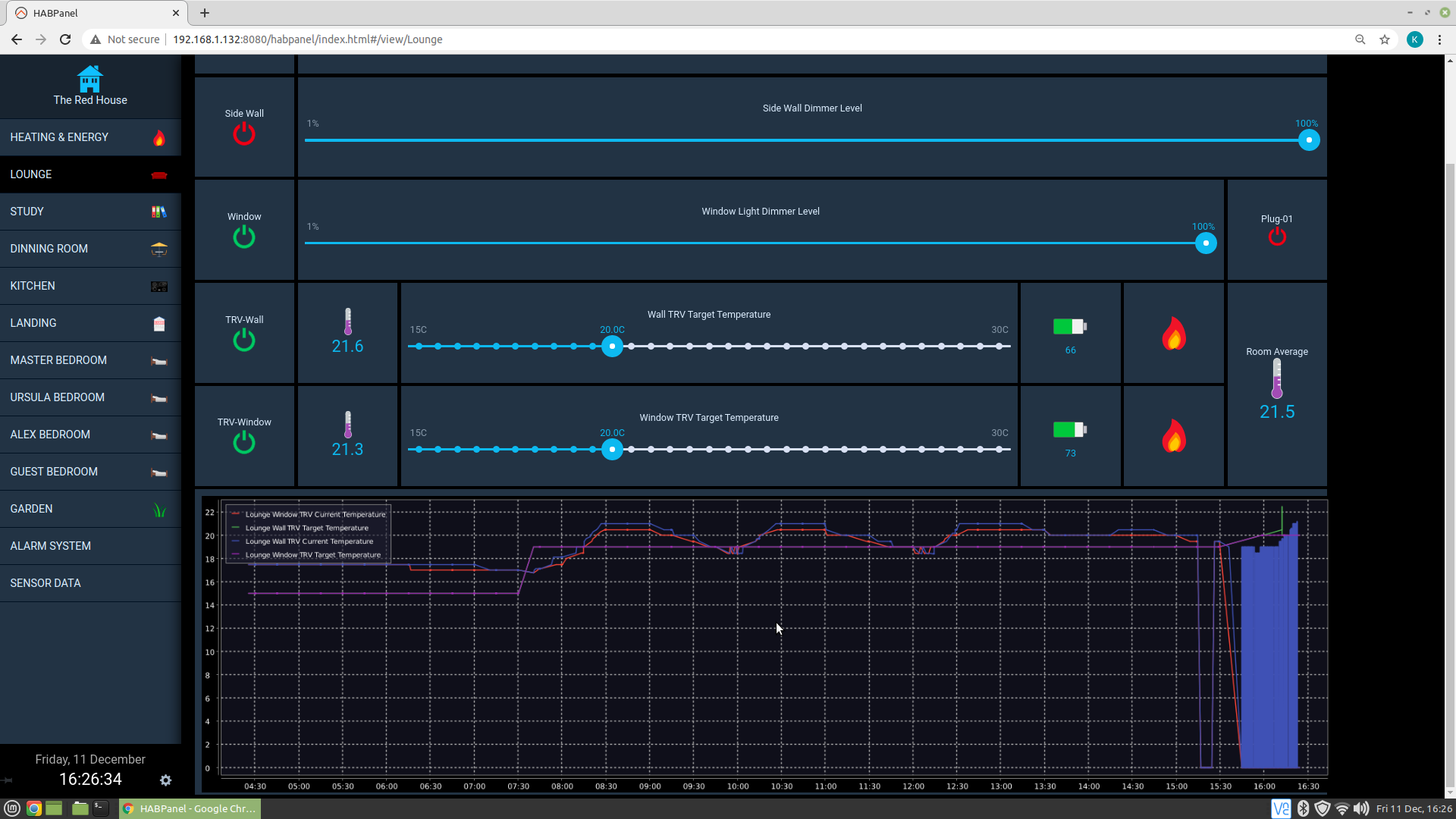

Ive just checked my TRVs and 3 are working correctly the rest are showing 0 for current temperature. strange behaviour
I could not see this in the HabPanel but when I look at whats in MySQL then the currenttemperature is obviously chaning between 0 and the correct temperature. See the attached graphic
