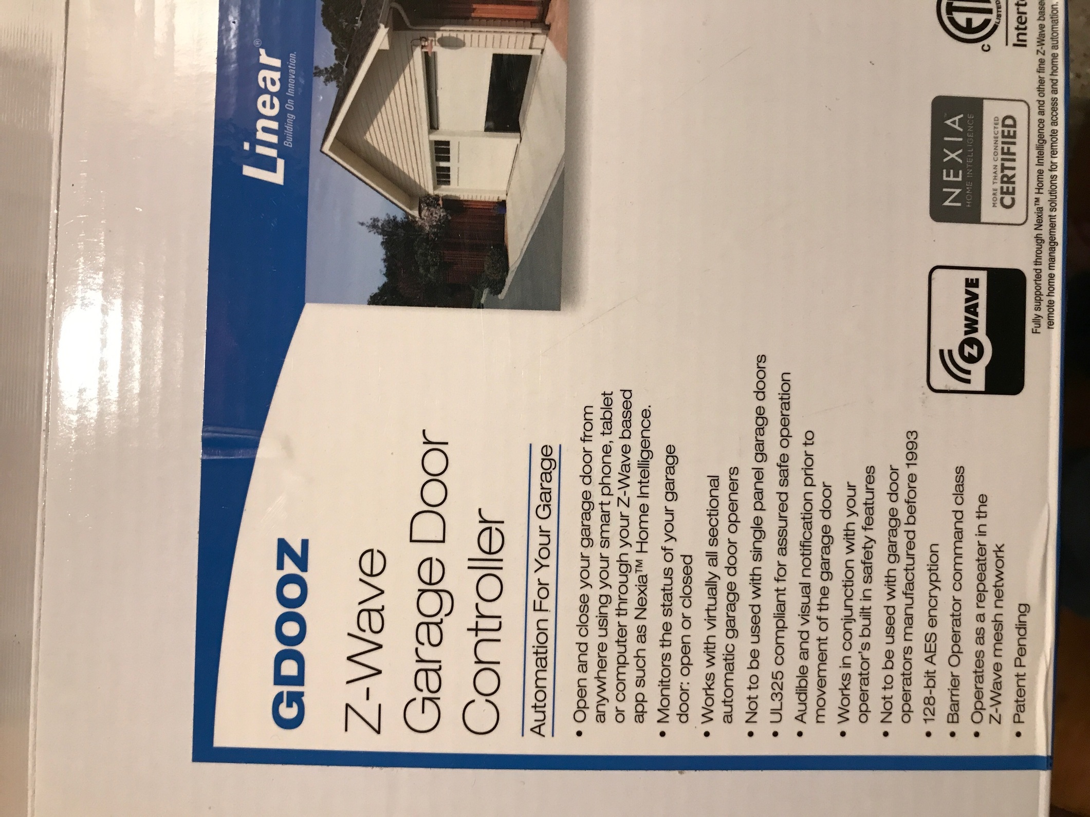

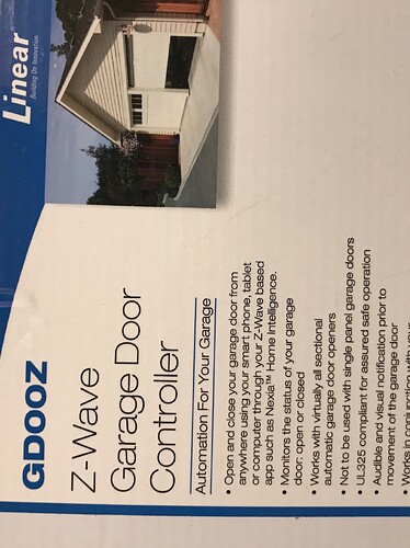

I have a Linear GD00Z Garage Door controller. It shows up in habmin as a NGD00Z-4. When I use the Paper UI or Habmin to link to the various channels, nothing seems to work. I have had no problem adding it to my network, but I cannot control it, nor will it update with the proper open close status. Here is what it shows up as in Habmin. I have also included the xml file. I have tried everything I can think of, granted I am still relatively new to openhab, and have been unsuccessful in making this item work. Any help would be greatly appreciated.

Not sure, but it seems to me that this is a secure Z-Wave device.

I think that this is not the Secure Z-Wave Binding.
This seems to me that this is the latest “regular” snapshot binding (I will double check also)
Did you follow the installation instructions here: OH2 Z-Wave refactoring and testing... and SECURITY - #6 by chris
You need to copy the network key (use HABmin), delete your Z-Wave things (PaperUI), uninstall the Z-Wave binding (PaperUI) and then install the new *.jar file manually.
