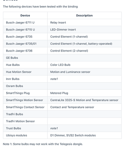

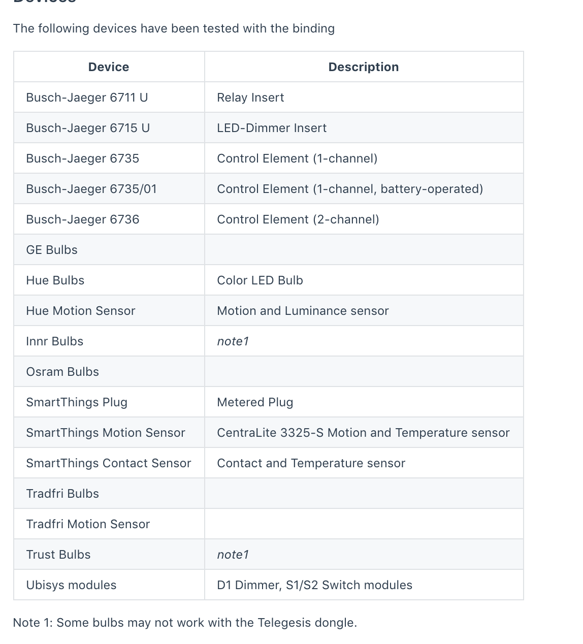

Thanks for your reply. But I’m wondering only those zigbee devices (less than 20, see figure below) are test and support. There are still tons of zigbee on the market. And I think for some of the zigbee deive in the list, it’s not so easy to buy them right now and maybe unavailable. Any other latest version?

This is not exactly true.
I have been having (still have) lots of problems with Zigbee, with Philips hue and Osram (lightify) devices, which doesnt seem to work stable using my Elelabs Rpi Shield Zigbee controller. Problem not yet fully specified though, so this may be a controller problem, or a binding problem. Noone seem to know atm.
I believe it´s a binding problem. But it may be a combination of both.
In general, the ZigBee binding should work with devices that are of similar type to those listed. The document shows the list of channels and clusters supported, but of course this probably doesn’t mean anything to you, and it’s sometimes difficult to find out from documentation how the device works.
In general, ZigBee is well defined (better than ZWave) and interoperable. However there are two issues that can introduce compatibility issues -:
  1. Different profiles - most of the time this isn’t an issue. The clusters are independent of profile, but sometimes devices will only work within a ZHA or ZLL network.
  2. The cluster library is quite vast, and sometimes devices are implemented in strange ways. For example, the latest SmartThings door sensor is reporting a flood alarm - this channel wasn’t previously supported, so we added flood alarm, and now that device is also supported.
Generally, I would expect that ZigBee certified devices can be made to work with the ZigBee binding, even if there may be updates required. If you are using the same types as those shown as compatible, then the likelihood is very high that it will work or can easily be made to work.
A small word of warning though - there are devices out there that may look like ZigBee devices, but aren’t really compliant. These might work, they might work a bit, or, they may just not work… Try and stick to certified devices :wink:
