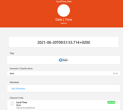

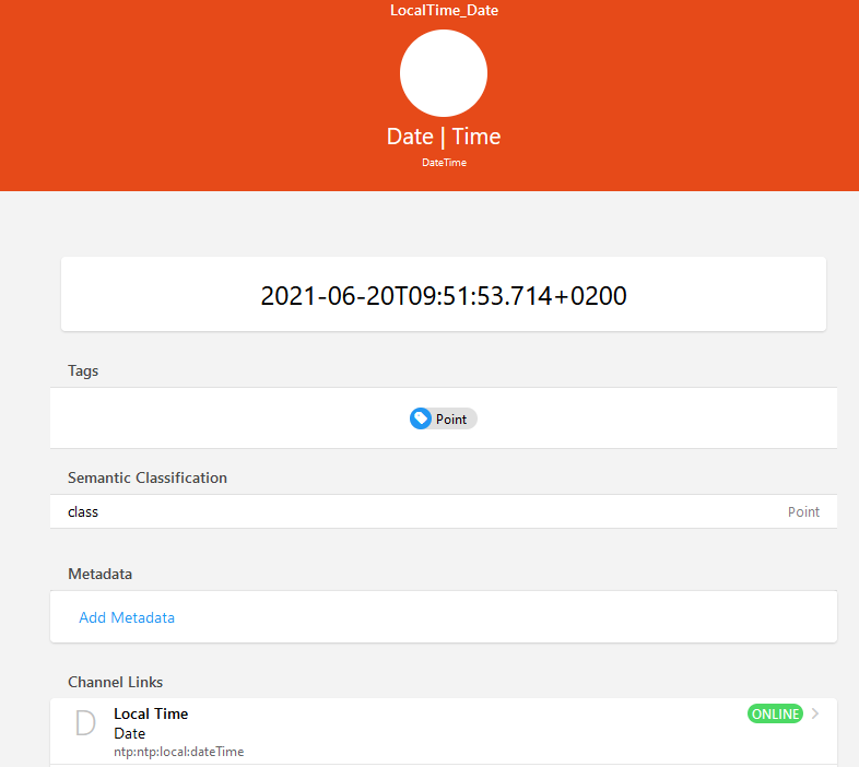

now the item looks OK and presents the date/time:

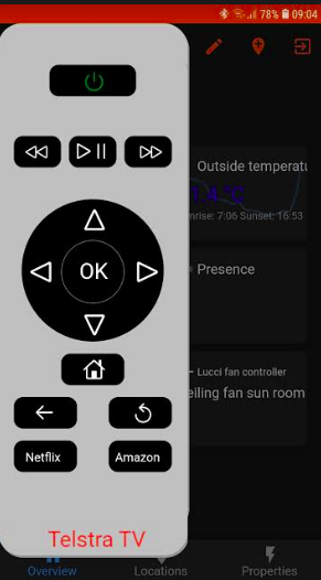

You can do cool things like this:
OK, but is this then phone browser (Safari,…) or still the mobile APP (which i guess requre sitemaps…)

Never used HABpanel so no it is not.

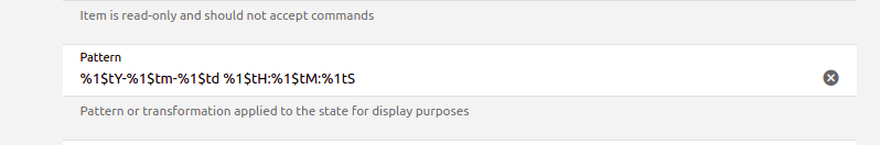

Search for adding metadata to the date item you created to format the date.
I have to go out now.
Go to the item you created.
Click add metadata
Click state description.
Put this in the state description.
%1$tY-%1$tm-%1$td %1$tH:%1$tM:%1tS
Then is will look like this.
  • 2021-06-11 11:00:21
