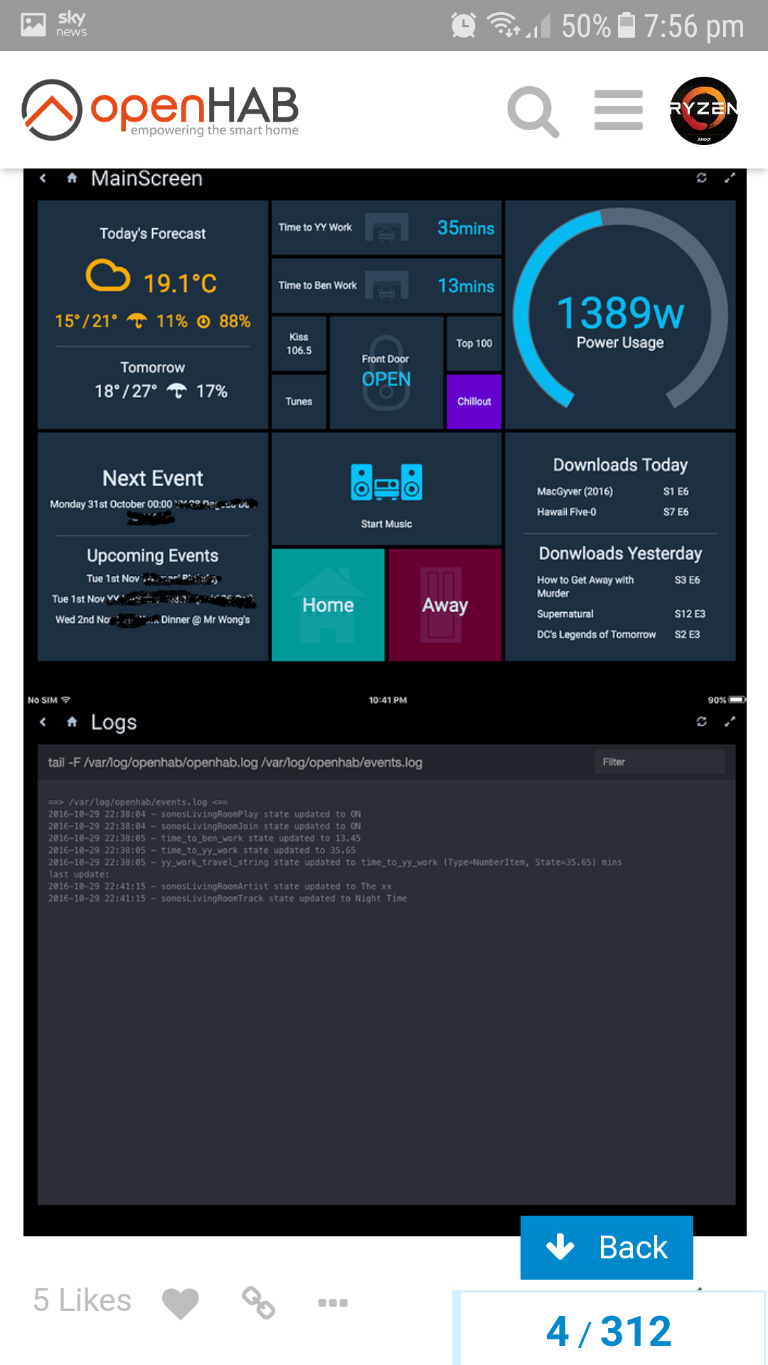

How do you add a log viewer too habpanel I have seen it done in a example
That looks like the log viewer just embedded as an iframe.

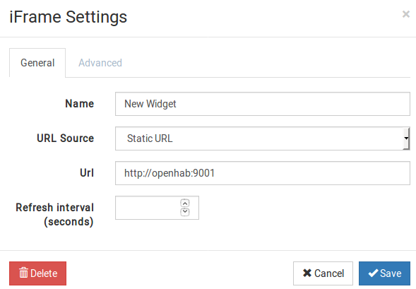

You need to install frontail
I have installed frontail already, can you tell us, how you can implement this into a habpanel widget?
Simply make a webview widget and enter the frontail url into this?
Create a frame widget and point to frontail:
Is there a guide for install on windows my OH runs on a Windows machine
So it install and setup frontail and then setup a frame in habpanel and point it to frontai

I haven’t used windows in years now but after a bit of googling:
You will need to install node.js with npm:
Then go to:
after setup frontail should be available at localhost:9001

I cant get this to work. Get no result in the widget.. Weird! I even tried with direct IP and localhost.
EDIT - http://IP:9001 works fine from a browser.
