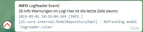

Just a quick how to about using the LogReader binding with the Telegram Action and format the messages with Markdown. Which is much more readable.
services/telegram.cfg add the parse mode
bot3.chatId=123456
bot3.token=your_token
bot3.parseMode=Markdown
rules/logreader.rules
rule "LogReader Error"
        Channel 'logreader:reader:openhablog:newErrorEvent' triggered
        // do something
        sendTelegram("bot3", "*ERROR* LogReader Event!\n%s Error Warnungen im Log! Hier ist die letzte Zeile davon:\n`%s`", logreaderErrors.state.toString, logreaderLastError.state.toString)
more about Markdown formats is Telegram format options
Have fun
Perfect, i hadn’t recognized the markdown mode yet.
Alltough it seems, that the bot or bundle does not render the inline code block currently.
Maybe this takes some time.
