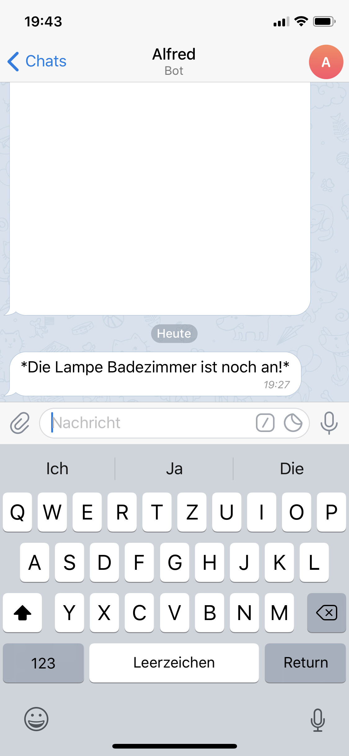

im currently experimenting with sending Telegram messages from OpenHAB (2.4) via the Telegram Action (1.13.0) and the Telegram Bot API. My problem right now is that I can’t seem to get text formatting to work. Not with Markdown and not with HTML. Below is my configuration and an example Telegram message.
I found another topic here in the forum where somebody does exactly what I’m trying to do seemingly without issue so I am wondering if I just missed something really obvious or it just doesn’t work the way I want to.
telegram.cfg
bots=abc_bot
abc_bot.chatId = 123
abc_bot.token = 123456789
abc_bot.parseMode = Markdown
default.rules
sendTelegram("abc_bot", "*Die Lampe Badezimmer ist noch an!*")
Example message
IMG_3404

Hi @Syn, thanks for the hint, the PR changes are actually already included the latest documentation so I expected the features to already be included in the public version which is not the case. I installed the 1.14.0 snapshot and now it works as expected!
Hi @Udo_Hartmann, I installed the snapshot and actually had to restart the container, but now it works without issue. Thanks!
