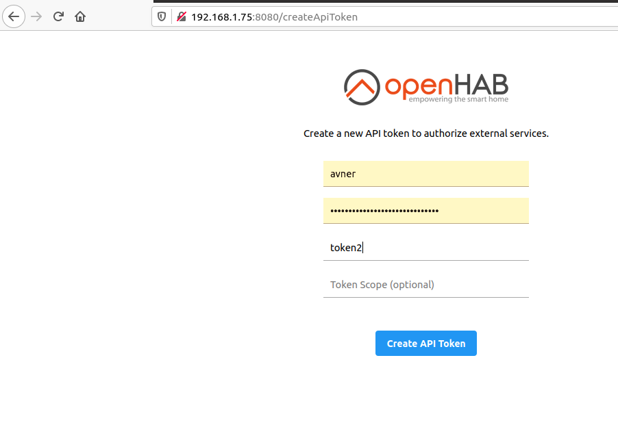

  • step2 - Create New API Token
    In oh3, to add the pushover Thing. I’m required to provide: User / Group Key
    Required Your user key or group key (USER_KEY) to which you want to push notifications.
    So I went back and created a token by clicking on the user → Create New API Token
    (see snapshot1, snapshot2)

snapshot1 - step2 - create token
snapshot2 - step2 - token is created
