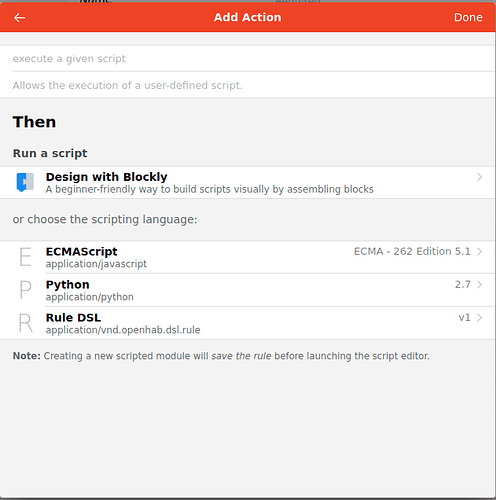

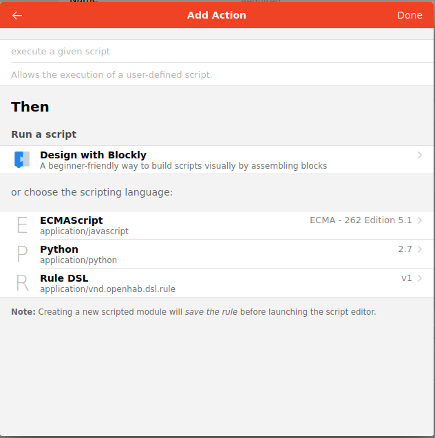

There’s a slight difference between the support of the various languages and the “scripted automation” setup. JS and Rules DSL are supported out of the box if you choose to create your rules through the MainUI and use script actions as one of the rule actions or if you use .rules files in the ./conf/rules folder. Jython scripting can be added as a supported language via the binding you found (also Groovy via a another binding).
Scripted automation is separate. It’s installed using instructions found above and allows you to create rules in various languages in the ./conf/automation/ series of folders and comes with the extensive helper libraries so that you can streamline your code.
