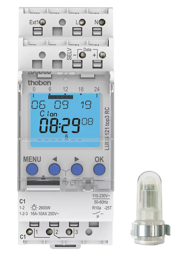

@rlkoshak @jimtng I don’t know if you guys have heard of this but basically it measures the lux and has a simple contact sunset on sunrise off:
How would I replicate the functionality of that using openhab and a lux reading ? For me the problem is that lux level goes back from 0 to whatever in the morning Wich is normal but how to ignore it during that period.

So in layman terms. A lux sensor can be from 0 lx till around let’s say 100000 lx. Now in the evening it will go towards 0 and in the morning goes from 0 till what I mentioned before.
The problem I want to solve is to have an item that updated to on when it’s evening and off in the morning.
Now that device that I mentioned early works like a charm you set min lux max lux debounce for example 15 minutes so if the lux fluctuates and also earlier off commands for example don’t keep the lights on all night.
