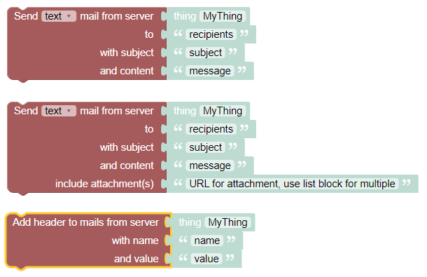

The library has two blocks for sending mail messages.
One block is for sending messages without attachments, the second block allows sending mails with one or more attachments.
Mail can be sent as text or html. Selection is through the dropdown box.
The server has the be the smtp server Thing configured in the mail binding.

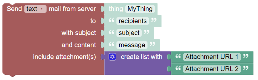

It is possible to send mail with a single attachment or multiple attachments.
By default, the block offers the possibility to configure the URL for one attachment.
To send multiple attachments, provided text block needs to be replaced by a list block with multiple text blocks, each containing the URL for an attachment, as illustrated below.
The mail binding supports setting headers on all mails sent from the server onwards. A block to set a header is available. The header should be set before sending a mail. Removing a header from all subsequent mails can be done by setting the header to an empty string.

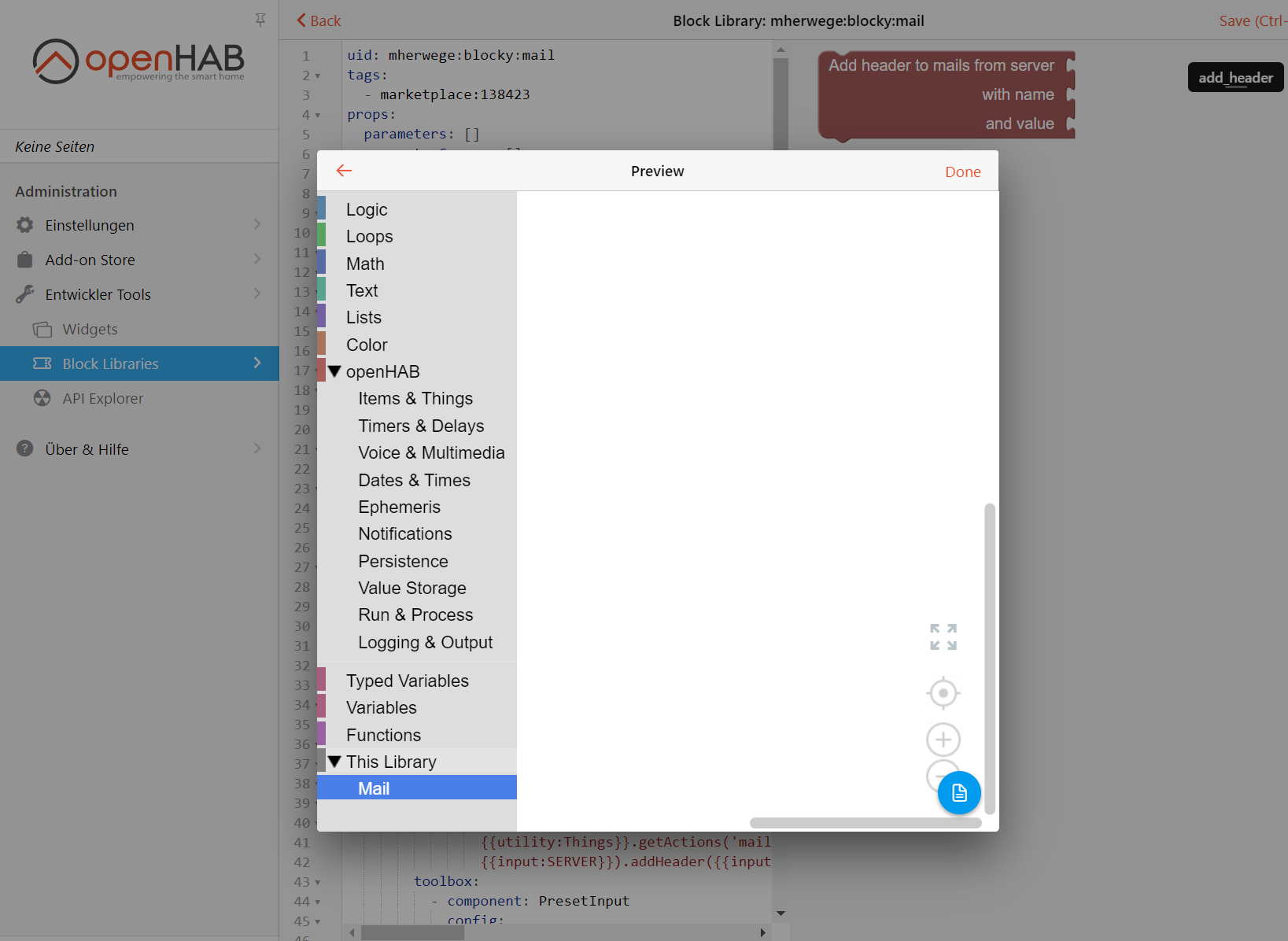

Since the update from OH 4.1 to 4.2.0 the mail action does not work in my blockly scripts anymore. The lib and the existing scripts show only the right part “thing MyThing” of the above shown blocks:
Also the preview in DeveloperTools/BlockLibraries is empty:
I already removed and reinstalled the lib via the Add-on Store and also manually via yaml file without success. Probably this is caused by the large blockly update?
See:
The problem should be solved. You may have to uninstall and reinstall the library.
Thank you so much man, looks good again after re-installing the add-on :slight_smile: :pray: Really appreciate the fast turn around time
