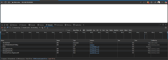

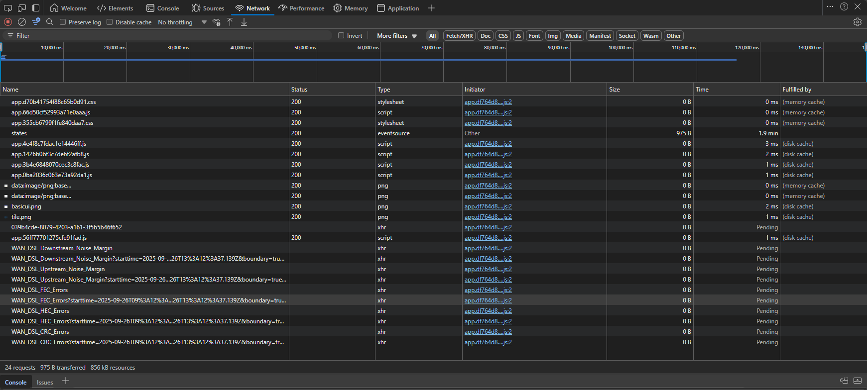

Just tried to replicate it. so after a while:
- click on any navigation entry
- “static” elements built themselves (images, css, …)
- “REST API” elements won’t:

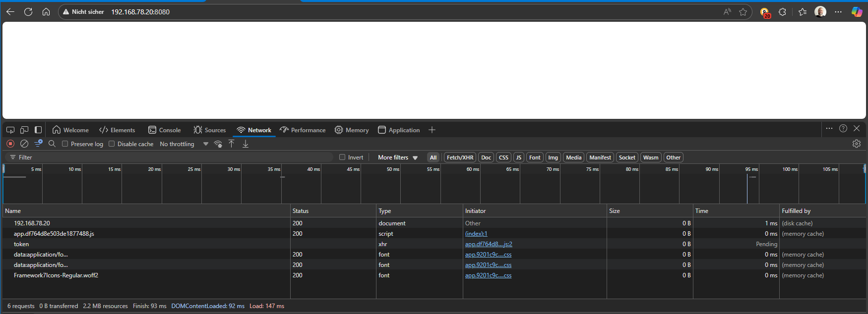

if you type in the IP/Port, the redirection to the /overview takes place, but also without REST API elements:

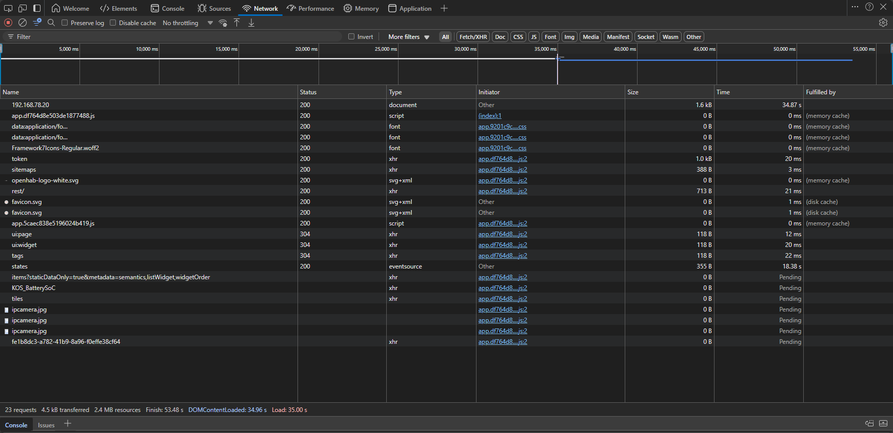

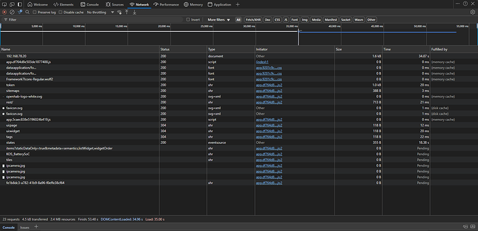

as you can see, the first request had almost 35secs for the answer, some elements are cached, but there’s also 200s on items directly from the webserver.
if I take an screenshot in between those 35secs you can see the “token”-request is the culprit:
