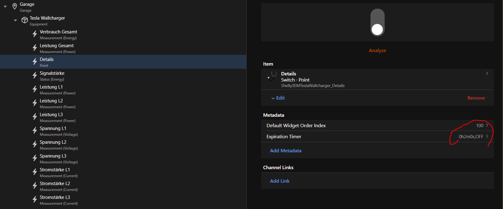

In the meantime I found a way that suits my needs to limit the list of points to only the most relevant. The less important points will be revealed only after a details switch has switched to ON. This keeps the less important point still accessible via the model cards after enabling the details view (instead of simply removing the less relevant items from the model completely).
Interim solution
To keep the clarity of a model card, I’ve introduced a dummy point (switch item) per equipment. The visibility of the less important points will be switched on/off by that item.
Example
This is the wall charger equipment in my garage:
As you see, there is a switch item with label Details added to the equipment Tesla Wallcharger. This item has no channel linked to it, just the expire metadata set which switches the item back to OFF after two minutes after switched to ON.

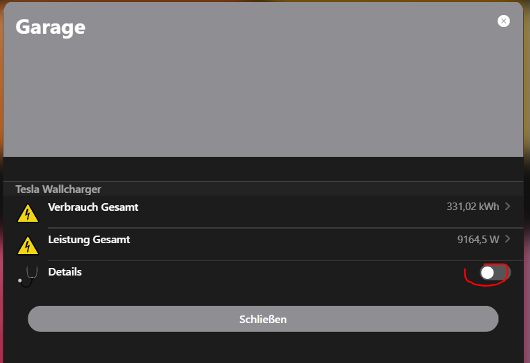

With this applied, we get a limited list of points when opening the model card for the location:

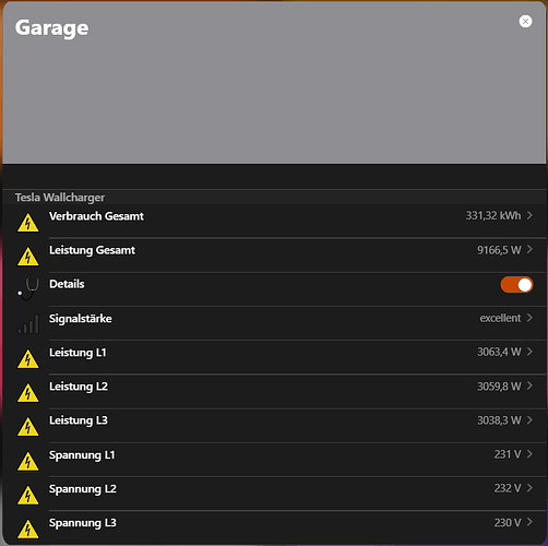

… and the long list after enabling Details:
