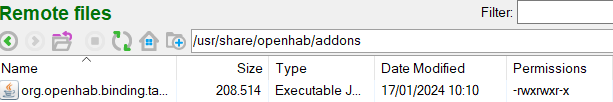

My folder structure looks different, I cant find conf and userdata, and the jar file is located in the addons folder here

That looks like the right place. Check the file permissions and ownership, make sure openhab can read it.
I was playing with the permissions but it makes no difference.
drwxrwxr-x 2 openhab openhab   4096 jan 17 13:14 ./
drwxr-xr-x 4 openhab openhab   4096 jan 17 08:54 ../
-rwxrwxr-x 1 openhab openhab 103990 sep  1  2022 org.openhab.binding.synologysurveillancestation-3.3.0-SNAPSHOT.jar*
-rwxrwxr-x 1 openhab openhab 208514 jan 17 10:10 org.openhab.binding.tapocontrol-4.1.0-SNAPSHOT.jar*
-rwxrwxr-x 1 openhab openhab     70 jan  7 22:04 README*
I think the problem is the jar file, I removed the Synology Surveillance Station addon from the marketplace and it works when the jar is manually placed in the same folder
Hmm… the synology jar shouldn’t have interfered, but I’m glad you’ve got it sorted.
No I think the Tapo jar is bad (or I used incorrect one). I put the Synology jar in, just to check if the location is good
