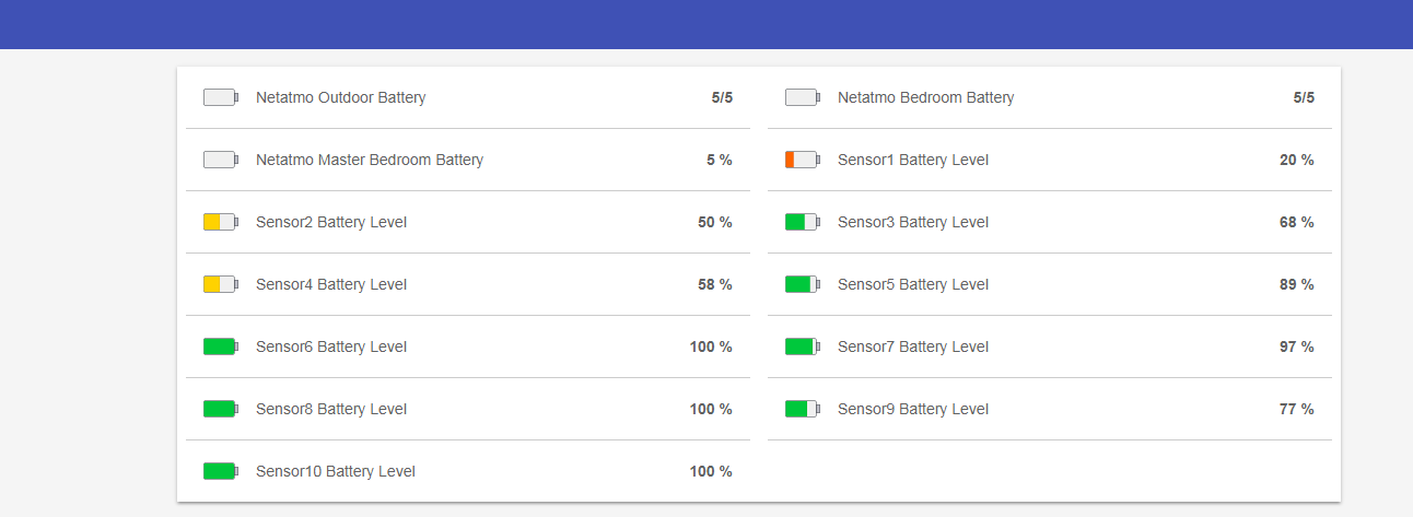

Map battery level to %
Most of my battery sensor uses battery level as % and this shows nicely in the sitemap, where icon shift colors depending on the level:
My items looks like this:
Number Netatmo_Bedroom_Battery "Battery status [%d/5]" (Group_Netatmo,Group_Battery){netatmo="xxxxxxxxxxx#BatteryStatus"}
Number Netatmo_MasterBedroom_Battery "Battery status [%f]" (Group_Netatmo,Group_Battery){netatmo="xxxxxxxxxxx#BatteryStatus"}
I also tried using mappings:
Number Netatmo_MasterBedroom_Battery "Battery status [%f]" (Group_Netatmo,Group_Battery){netatmo="xxxxxxxxxxx#BatteryStatus"} mappings=[1=20,2=40,3=60,4=80,5=100]
So how can I convert the number 5 to 100% so that icon shows correctly up in sitemap?

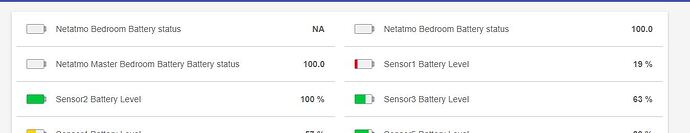

However i can not get it to work properly, get the % sign to show up.
Text item=Netatmo_Outdoor_Battery label="Netatmo Bedroom Battery status [JS(netatmo_battery.js):%.0f %%]" icon="battery"
			Text item=Netatmo_Bedroom_Battery label="Netatmo Bedroom Battery status [JS(netatmo_battery.js):%s]" icon="battery"
			Text item=Netatmo_MasterBedroom_Battery label="Netatmo Master Bedroom Battery Battery status [JS(netatmo_battery.js):%f]" icon="battery"
what am I missing to get the icon to show up correctly?

Grrrr. I thought that the JavaScript would return an integer but it is returning a float.
return(Math.round(i*20));
Then use label="Netatmo Bedroom Battery status [JS(netatmo_battery.js):%s %%]"
That will fix the icon problem.
Or not. The Icon is based on the actual state of the Item, not just its transformed label. You will either need to make new battery icons that go from 0 to 5 or you will need to use the Rule.
