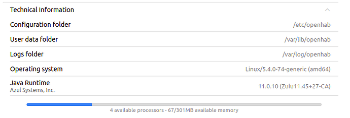

Actually, I’m really not sure which Java version I have as this has become much more difficult with DSM 7.0 on the Synology. I spent several hours trying to figure this out, but didn’t get there (“java -version” in
ubeaut
(Greg)
June 20, 2021, 4:48am
5
From the UI Help & About then click Technical Information.

7
Thanks - I missed that. Mine reads the same as yours.
