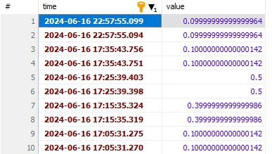

For some reason, I get double entries in the database when using ‘EveryUpdate’ as a strategy for that specific Item. The Item is not in a Group policy.
the Item with the double entry is the one starting with Netatmo_regen, jdbc.persist looks like this:

double entries:

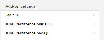

In the JDBC settings, I also see a MySQL and a MariaDB entry, both configs are exactly the same and point towards MariaDB.

It’s doing exactly what you told it to.
First of all it’s important to realize that strategies are additive. So all your items will have everyChange and restoreOnStartup. In addition to those, Netamo_regen_RainDelt will have everyUpdate.
Since a change is an update the value gets saved once for the change and again for the update.
hi @rlkoshak thanks, I tried already to delete the default strategy, worked but no other item was updated. The double entries in the database are all after a change in valure, so the strategy does what I told it to do. But how do I tell the default is on everyChange, and the exepctions should update on everyUpdate.
