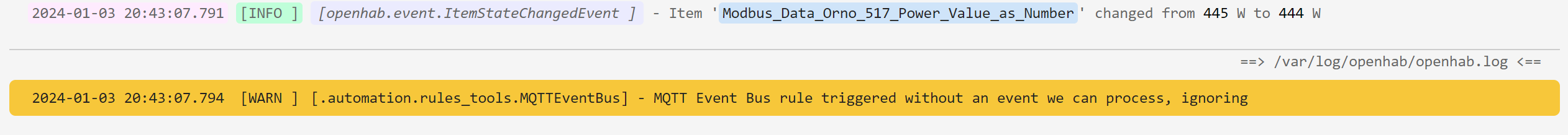

Hello Rich,
I, too, don’t really need to link two openhab instances, but rather only want to do the same as Erik, publish state changes of OH items to MQTT. I could go the route of a Generic MQTT thing, but since I have quite a few items to publish, adding them to a group is a lot easier than creating MQTT channels and linking them. So basically using 1/4 of the function of the Event Bus.
I’m very sure that I have the configuration correct (I created the Publish-Channel on the MQTT bridge thing), even tried switching out the groups, but also run into the same error:
MQTT Event Bus rule triggered without an event we can process.
Any idea on this?
Put the rule into debug level logging by setting the logger level for org.openhab.automation.rules_tools.MQTTEventBus to DEBUG in any of the usual ways. There is also a line you can uncomment at the top of the Script Action to put the rule into debug logging.
It might be the template needs to be updated for a change in OH 4. A new Item event was added.
I’ve added some updates to the logging also so please remove the old template and add the new one and reinstantiate the rule.
That might be better handled using a rule with the publish Action. You’ll have a lot more control over how it works.
