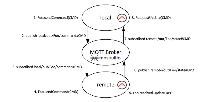

Let’s assume there is a command on Foo on local. The data flow will be:
  1. command received by Foo on local OH
  2. command is published to local/out/Foo/command
  3. command is received by remote OH and triggers the event bus subscription Rule (see below)
  4. remote OH Rule calls sendCommand("Foo", "CMD")
  5. eventually Foo may receive and update as a result of the command
  6. remote OH publish Rule triggers as a result of the update and publishes the update to remote/out/Foo/state
  7. local OH receives the update and triggers the event bus subscription Rule (see below)
  8. local OH calls postUpdate("Foo", "UPD")

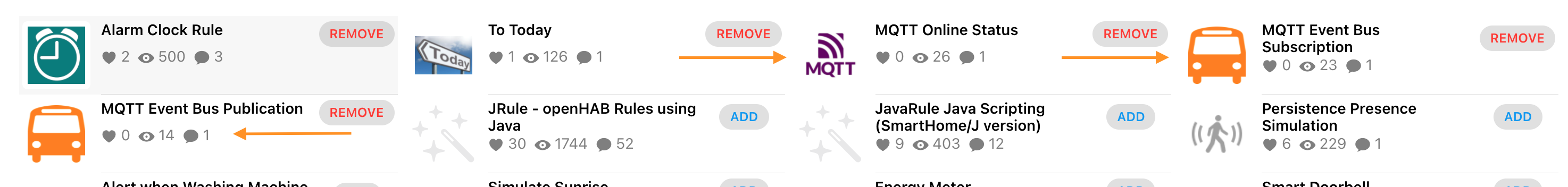

Find and install “MQTT Online Status”, “MQTT Event Bus Subscription”, and “MQTT Event Bus Publication”. You may need to click “Show All” to see them all.
Configuration
What you have installed are rule templates. Templates can be instantiated one or more times to become rules. You will want to instantiate at least two of these rules, depending on the scenario.

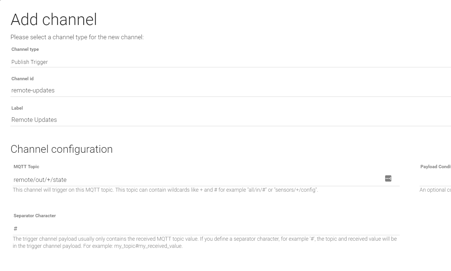

In MainUI from Settings → Things open your MQTT Broker Thing and click on the “Channels” tab.

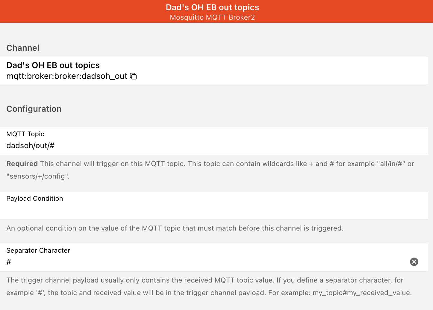

Click on “Add Channel” and configure it with a wild card subscription for the root topics on the event bus where updates and commands will come from. The specific topic will depend on the scenario this event bus is being used for.
In the example in the screen shot below I’m subscribing to sensor Items on an openHAB instance running at my dad’s house. So dadsoh “owns” the sensors meaning my “main” openHAB subscribes for updates.
Put a # into the “Separator Character” field.

For subscription we need to create a publish trigger Channel on the MQTT Broker Thing. This subscription will be subscribing to the desired out topics on the publishing instance of OH. MQTT and configure it to subscribe to the output topics from the other openHAB. You can use the wild card subscription to use this one Channel for all the Items. Be sure to define a separator character so we can get the MQTT topic from the event in our Rule.
In PaperUI navigate to the MQTT Broker Thing. Click on the + icon to add a Channel and enter:
Field Value Notes
Channel Type Publish Trigger The only choice
Channel ID <client-ID>cmd, upd Choose a meaningful name indicating what OH instance the Channel subscribes from (e.g. in this case on remote we subscribe to commands from local so use local-cmd.
Label Human readable name for the Channel Spell out what this Channel does, e.g. “Local’s Commands”
MQTT Topic On the local openHAB subscribe to remote/out/+/state, On the remote openHAB subscribe to local/out/+/command If you want to subscribe to both commands and updates from remote subscribe to remote/out/#.
Separator Character # Triggers the Rule with and event consisting of topic#message.
If you have more than one “remote” OH instances, create a Channel for each instance. Alternatively, if this openHAB instance doesn’t publish anything to the Event Bus (e.g. the remote OH instances only publish sensor readings) you can subscribe to +/out/# which will subscribe to all events from all other instances of OH. If you do that and do publish for the local instance of OH, an infinite loop will result.

I said I won’t put much effort into it until what I’ve already submitted gets merged. I didn’t say I’m not going to not work on it much at all for ever.
That’s exactly what rule templates are.
Sorry thats what I meant.. I took that for granted I gues..Sorry!
What I meant was, the event bus got a part of the system itself, as an direct option in the setup where you specify wheter you need to activate this even bus, and if yes, then there would be an option where you place to where, and which funktions/items/things etc you want to share between the systems.. The actualy communcation should then be established automaticly. Perhas like main system “download” a list of all resources/items/things ext from the other(s) system(s).
